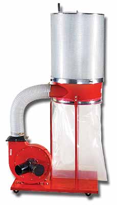

In our shop my dad has this PSI 2hp dust collector
with 6 inch sewer & drain PVC. It's not grounded and it works great. He found the pipe at Agri Supply for $5 for 10 feet. It was cheaper than the cheap metal duct at home depot. Lowes had all the 6" fittings really cheap too. The biggest improvement we made to the dust collection system was to change the outlet of the dc blower from 5 inch to 6 inch The blower already had a 6 inch inlet.
