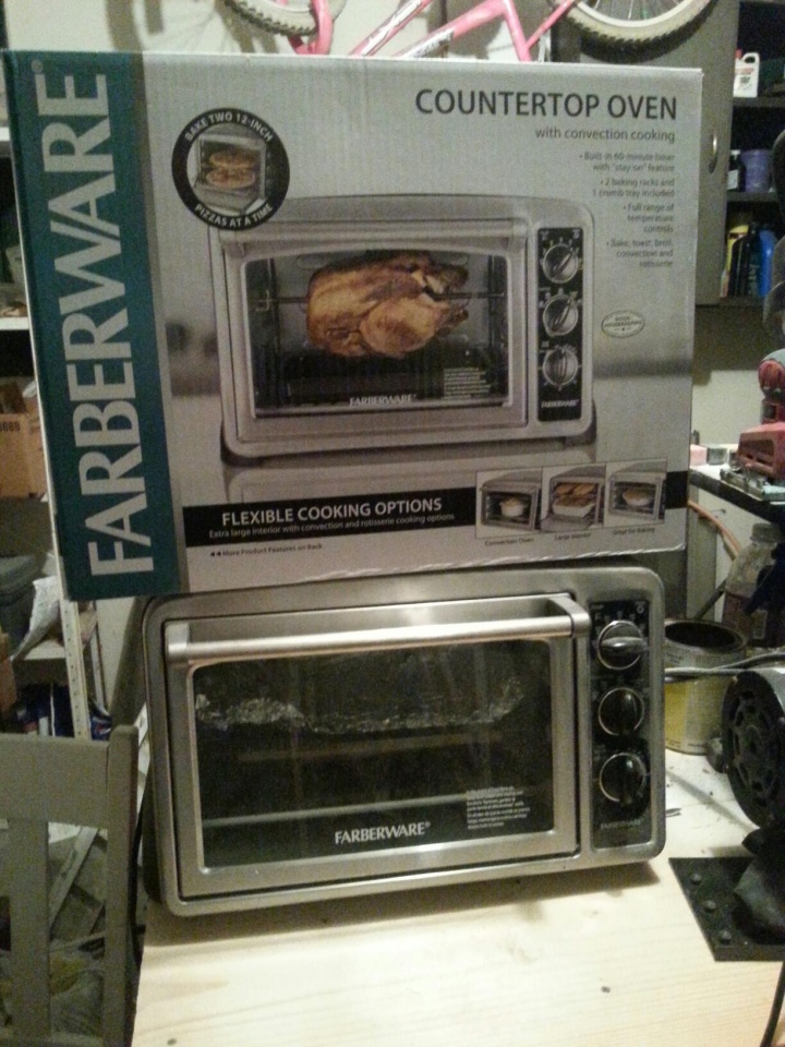

Here's mine - Wal-mart about $50:
This is the one I ended up buying. It has the convection feature, a 60 minute timer, and a Stay On option. It's plenty big for my purposes.

I bought the same farberware from walmart today. For those of you with this oven have you checked the temps with a thermometer? On the 150 degree (lowest) setting I'm getting between 230-250 degrees. I'm wondering if i should return it or exchange it. I'd like to get down to 185ish.
When did you take the reading??? Turn the oven on and let it heat. Let it cycle a time or two. When it clicks off then take a reading. If yours is like mine those dials are not accurate. When I want the lowest setting I just turn the knob and when I hear it click on that is my lowest setting and it is usually below the 150degree mark. Then I adjust from there. I always just go by feel when casting or powdercoating.
i left it on for 2 hours and it stayed up around 230. Unfortunately on this oven you cannot turn it below the 150 mark.
I took mine back. I didn't use a thermometer, but it was way too hot to use for blanks. I'm thinking mine was on high no matter what temp I set it at. Sorry James, if I'd known you were looking to get one, I'd have warned you off this model.
