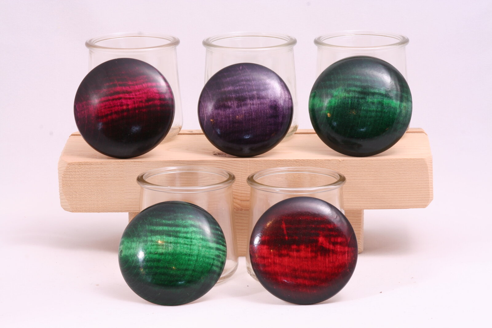

I use spray on some items, but not pens to be truthful. The thing is you need good ventilation and a way to rotate the item for even coverage. The area needs to be clean too so you don't get dust on the work. I've found it to be a good finish on jar tops, pendants etc. though I usually use wipe on ploy which is an easier application. Not advocating for anything, just my experience.

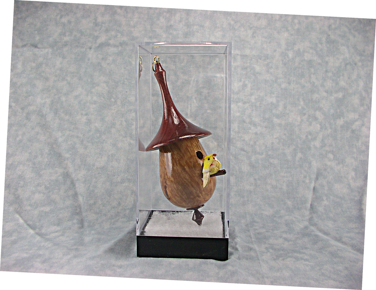

David brings up a couple good points and I will share how I do my birdhouse ornaments and so easy to do with pens. I use a dowel to hold item as you can do same with finished turned pen blanks. I use some doublesided tape on dowel to hold item in place. Just slide tube over the edge of the tape just enough to hold it. Easy to spray all around while holding in hand. Then I take an old cardboard box and put holes in it to hold the dowels to let dry. been doing this for years. I spray outdoors in the shade and on nice days no humidity and not hot. I use a respirator mask when doing these but again very easy to do. I do them in batches. Lacquer is so forgiving and the hardness is great as well as the shine. It does dry to the touch quickly. Now the more coats used the longer to fully cure is needed. There are charts on all that stuff on the net. The more coats the deeper the look is and again no sanding between coats. If you use poly you need to sand between coats for a nice finish. Good luck.

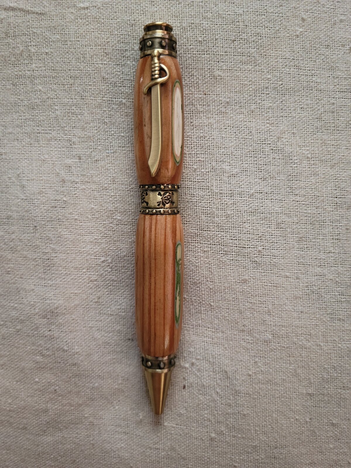

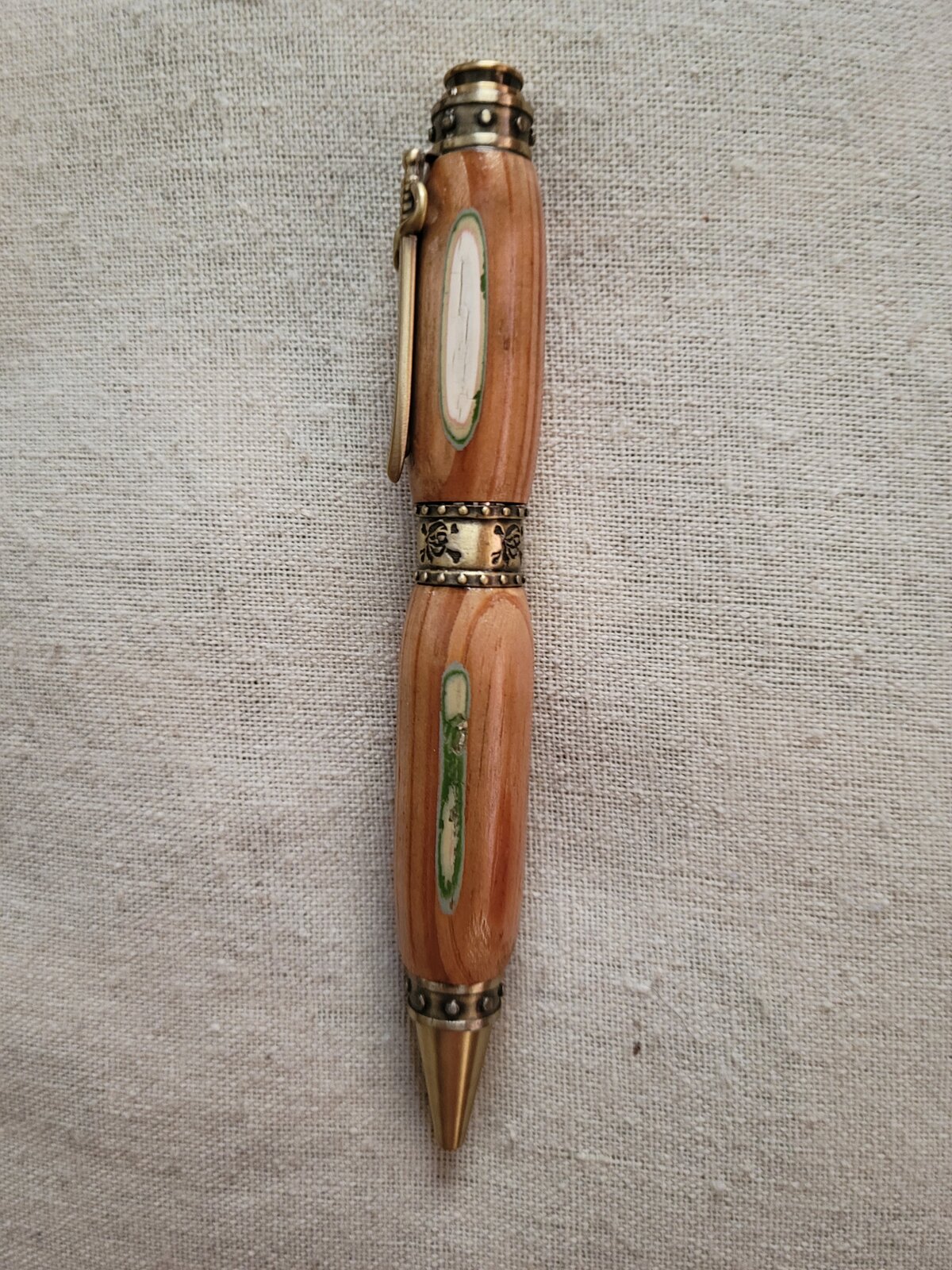

Not bad for a first try. Thanks to Mike Hardin at stadium pen for his off center drill video.
