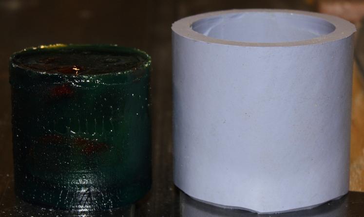

You can always make one out of silicone like I did.....It works great and you don't have to worry about it not coming out of the PVC piping. I have experience with that issue.......
