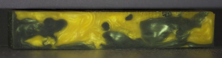

For instance this one is two mixes per color, so 4 pours.
We waited until the green started solidifying then poured in the yellow and "swirled" but since the green was already thick it just shoved around in blocks.

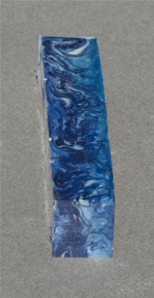

And this one is 3 colors just poured and swirled as fast as we could.
GK
