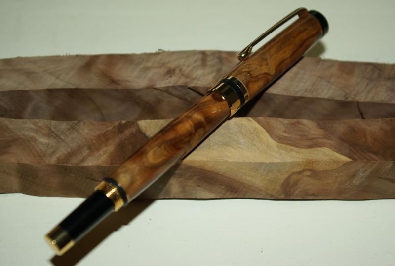

I got some Bock 180 nibs and put one on this Classic that I turned recently out of hickory. Now not only do I like the looks of the pen I love the way it writes.
