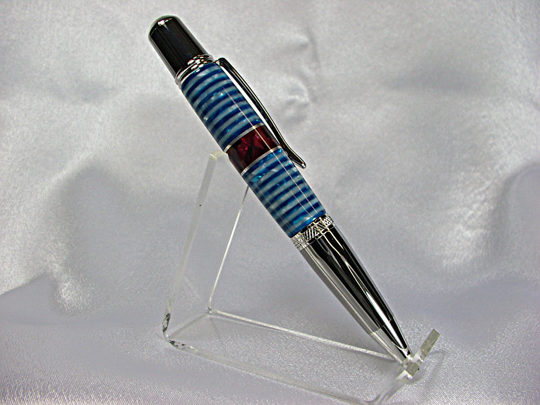

Picguard material was mentioned a few times here. Just thought I would show a couple pens I made from actual guitar picks. They also come in different metals so choices are even larger. Yes the colors are oustanding. You can also find it on ebay where I found these. Used epoxy t88 to adhere all together. Combinations are endless.
