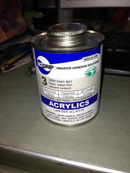

This might be the stuff you want to use. I haven't personally used it, but I saved this site when other IAP members were discussing this issue some time back. Here's the link:
Delvie's Plastics Inc.: Acrylic Cement
I have used the Weld-On #3 and applicator bottle from them. It was nice because I could hold the parts in place and then let the glue wick into the joint. It was easier than trying to line things up with the glue already on them. It made a really strong bond on the acrylic sheets I glued together.

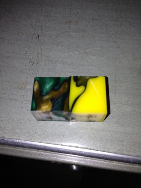

You question made me curious. And since I own a sign shop and we work with acrylics all day I tested it out to see. The solvent basically welded the two scraps together as one piece. I tried to get them apart with a hammer and chisel and it isn't coming apart. Make sure both surfaces your going to use the solvent on are perfectly flat. The solvent is water thin so will wick into the joint but if its not flat it wont weld it. Even the roughness of table saw cuts must be removed.

Why not Testors model glue then, I have had CA and regular 15min epoxy break at the glue joint. or for that matter plastic weld Epoxy
Well give it a try and see, but I'd wager it will fail also.
Monty, it did fail after a couple of days... However when I left it alone for about a week or so.. Couldn't break it with a hammer.. Yet I wouldn't recommend Testor's model glue even then.
