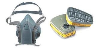

I use a 3M Respirator from Rio Grande Silversmith Supplies. The mask is about $24 the filters are $9 for 2. Works great. I'm sure you can get it other places too.
