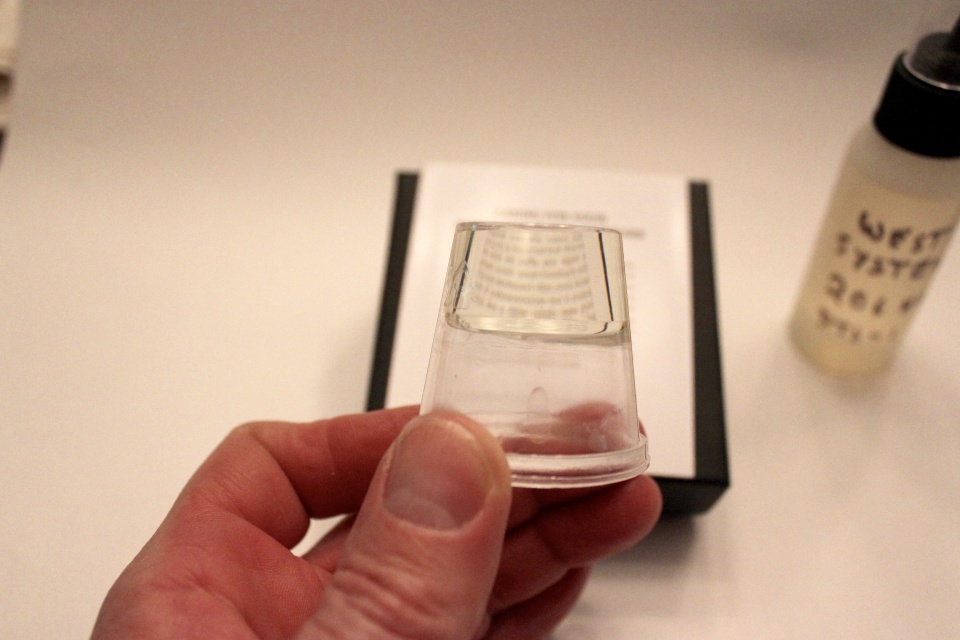

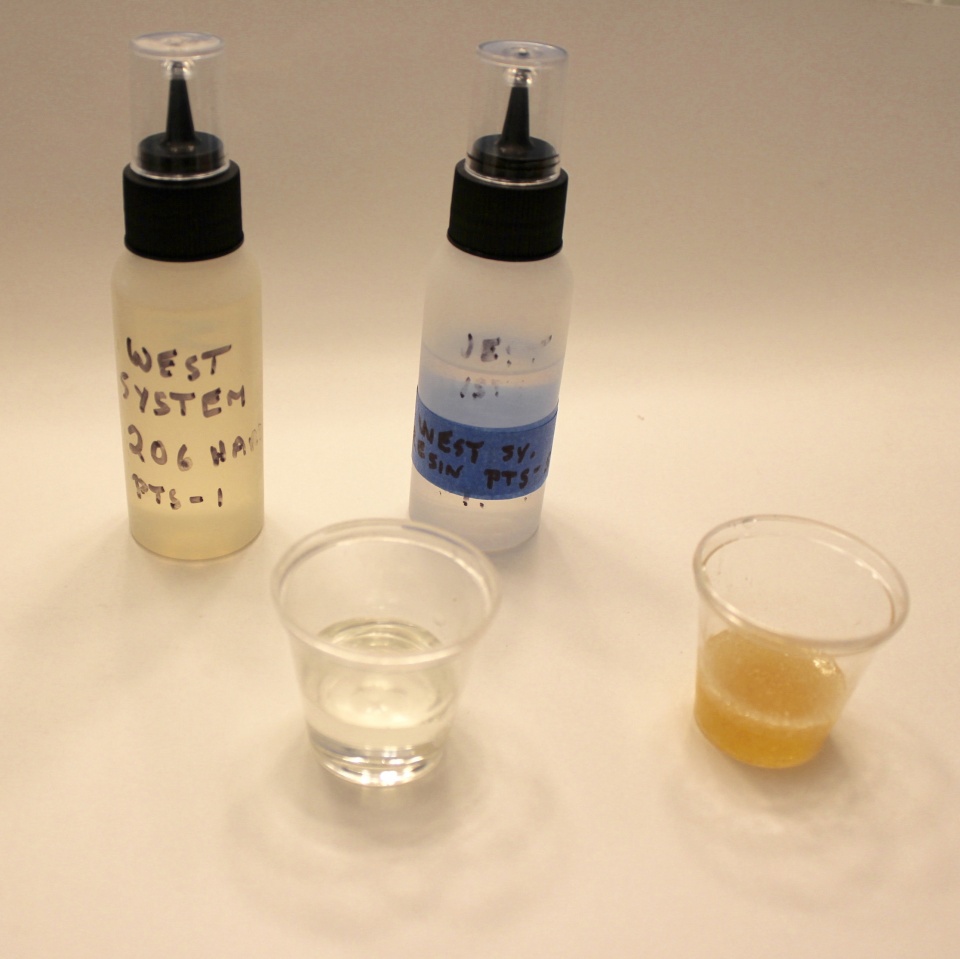

I have been curious about the glue lines in segmenting, so I made these several weeks ago.
The clear cast is West Systems 105 and 206. The marine store by me did not have 207, so I did order it online as I would like a very clear glue line.
These are about 2 weeks old, and I have not done a 105 and 207 test. After the 105/206 dried, I question if the 207 will be much better as this is very clear, with no tint.
While I cannot cay that the 105 and 206 are an "optically clear" cast... I can very clearly read through the top to bottom; from the side the image is distorted I assume due to the curve of the cup. NO BUBBLES also - just mixed and sat on the bench since then.
The yellow cast is my typical brass tube/blank 5 minute epoxy - tons of bubbles, but has served me well.
