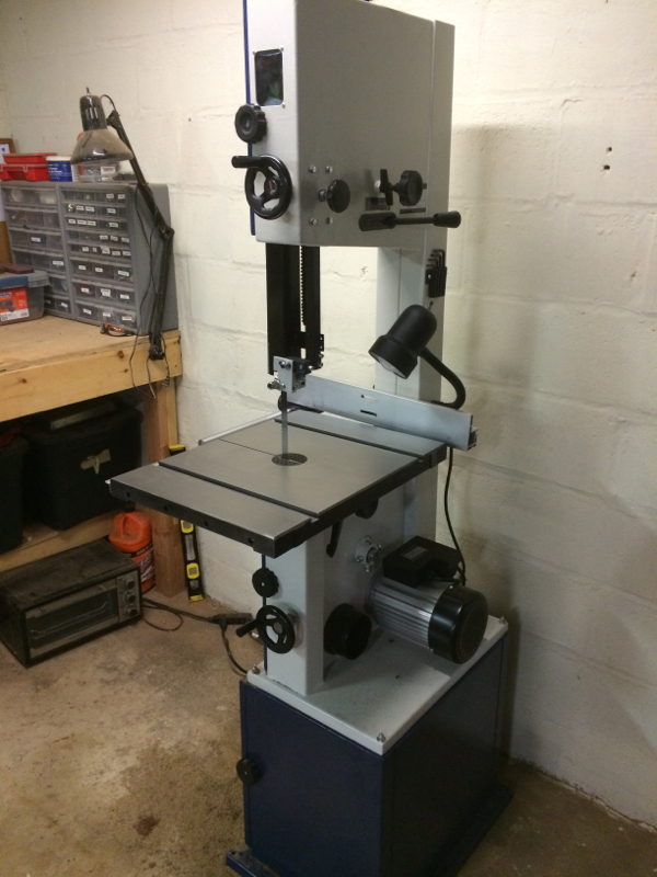

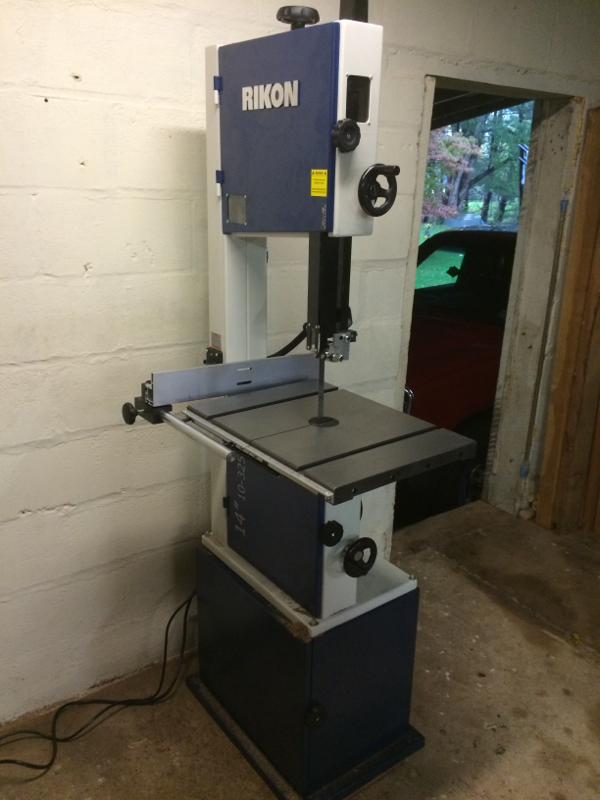

Picked up the Rikon deluxe 14" bandsaw and got it put together today.
It wasn't bad to put together although the instructions are terrible.
I'm still messing with the guides a little to get them dialed in.
The blade was running too far forward on the bottom wheel so I had to adjust it a little. Pretty easy to do.
There is a tiny bit of vibration - maybe some more fine tuning on the lower wheel? Nothing substantial though.
Man does this thing cut great. I used to have to feed everything thick through my old saw slowly.
This saw has a lot of little features.

Sweet band saw Dan!
As for the vibration, make sure the tires are fully seated on the wheels and that your drive belt is tight. Try running it without a blade. It could also be the blade itself. If you have an extra, try it next.
Then order some Timberwolves blades.
Good luck!

Seems like the timberwolf is a popular choice here.
Good call on checking the belt. I actually backed off the tension a but fearing I might have tightened it too much so that's worth checking. I little odd the a woodcutting bandsaw would have two speeds / pulleys.

Sometimes a belt that is not taut can flutter/shudder with the vibration/harmonics of the motor, drive wheel, flex in the cabinet/stand and or housing.
From the pic, looks like the motor is close to the drive wheel. Not as much chance of fluttering I would think.
Sometimes a belt can have a hump where it is joined and cause it to bump every time it goes around a pulley.
Run the motor without the belt. Then try it on the other speed.
Make sure the pulleys are tight and the motor mounting bracket does not have any play.
Hope this helps.
