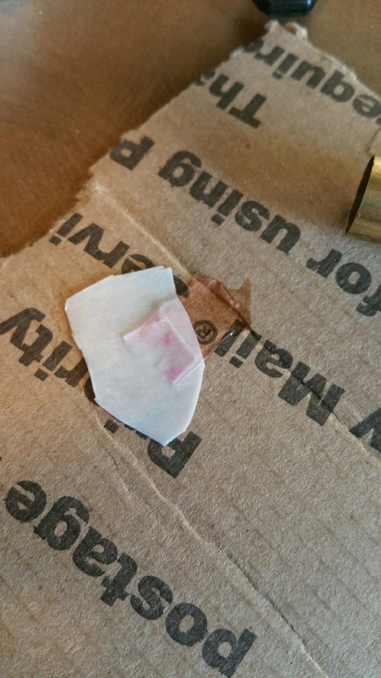

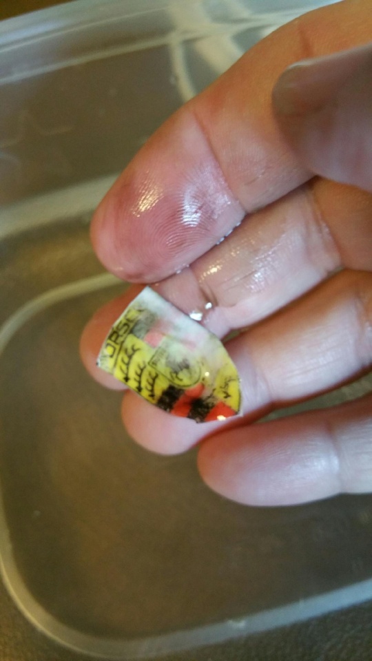

Need a little help please.
I printed some pics onto water slide decal paper (testors). After soaking in water for about 20 seconds, the ink came off. I used an ink jet printer and the decals have been dry for at least 8 days before attempting to put on the blank.
What happened?
Why did the ink come off?
Do i need to seal the ink before putting in water?
