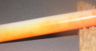

Okay, here is the blank that took the teflon with it.

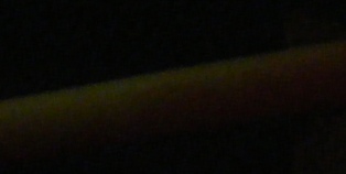

It didn't swirl as much as I'd hoped, son one side is Flourecent Orange and the other..... kinda whiteish. But it also glows in the dark :) (hard to photograph)

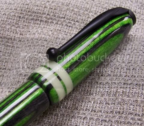

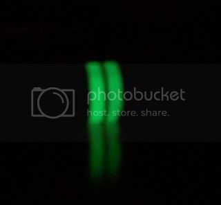

Sweet, glowing powders? I've done that with some centerbands. The suff I got glows pretty bright!
