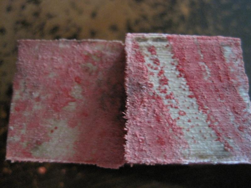

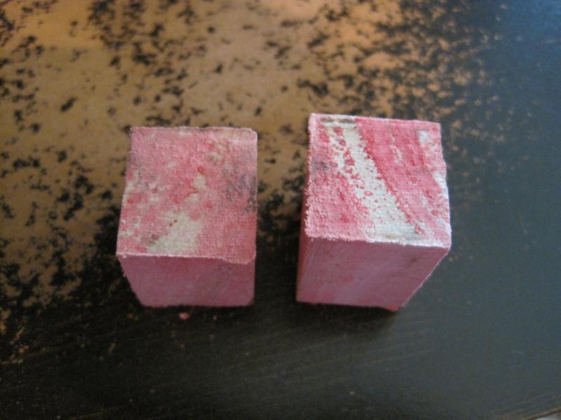

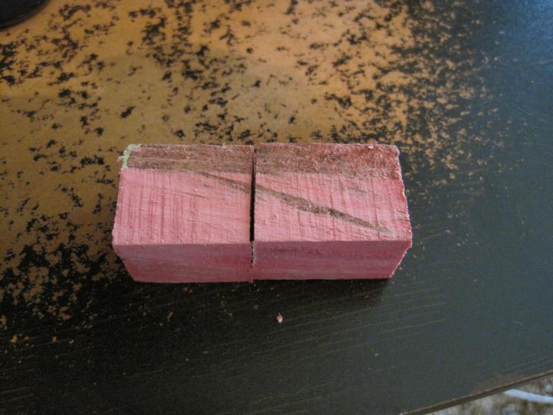

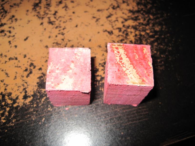

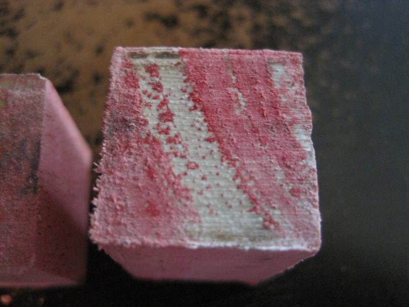

1st test. Piece of 7/8sq Pecan Red Food Coloring under vacuum for 1.5 hours until the bubbles stopped. This is very promising. I did not have a lot for color in there so I got pink. May run to WC and see about picking up some Mixtol. I also have some Mica powders coming w/ a resin order. Will that disolve in DNA or MS?
I'd think no on the mic powders. The reason is that they're pigments, not dyes and hence much larger particles that I wouldn't expect to penetrate.
OTOH- try it and let us know if it works.
I've dyed a few and my best results were turning and sanding to finished size and then adding the dye.
For dying before turning I got my best results using an alcohol based dye, alcohol being thinner than water it seems to penetrate better. I drill the hole for the tube then drop in the dye. Pull a vacuum and leave for a couple days. Results will vary depending on the wood. Maple doesn't do well this way but does great if surface dyed just before adding CA finish.
