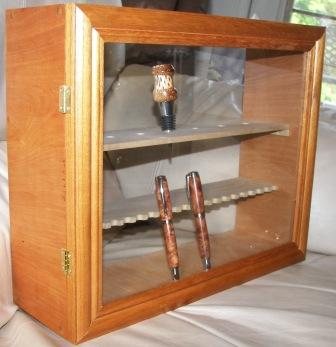

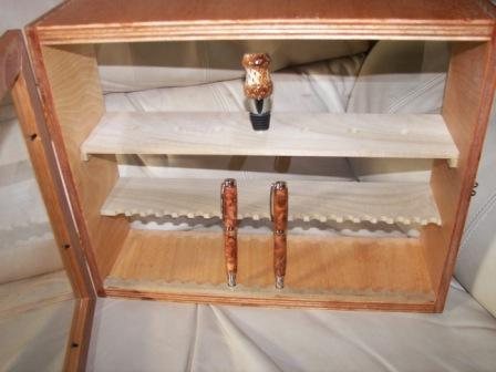

Here's one I made when a friend asked me to display in her bank. If you want to hang it on the wall you could make it narrower and put a wood back on it. Let me know if you want more detail.

Bruce's cabinet looks fine. Just be cautious about what kind of wood and finish you use where the pens rest. I made display stands from aromatic red cedar. After only 24 hours the finish was damaged on all of them from contact with the cedar. You might want to consider lining the rests with felt.
