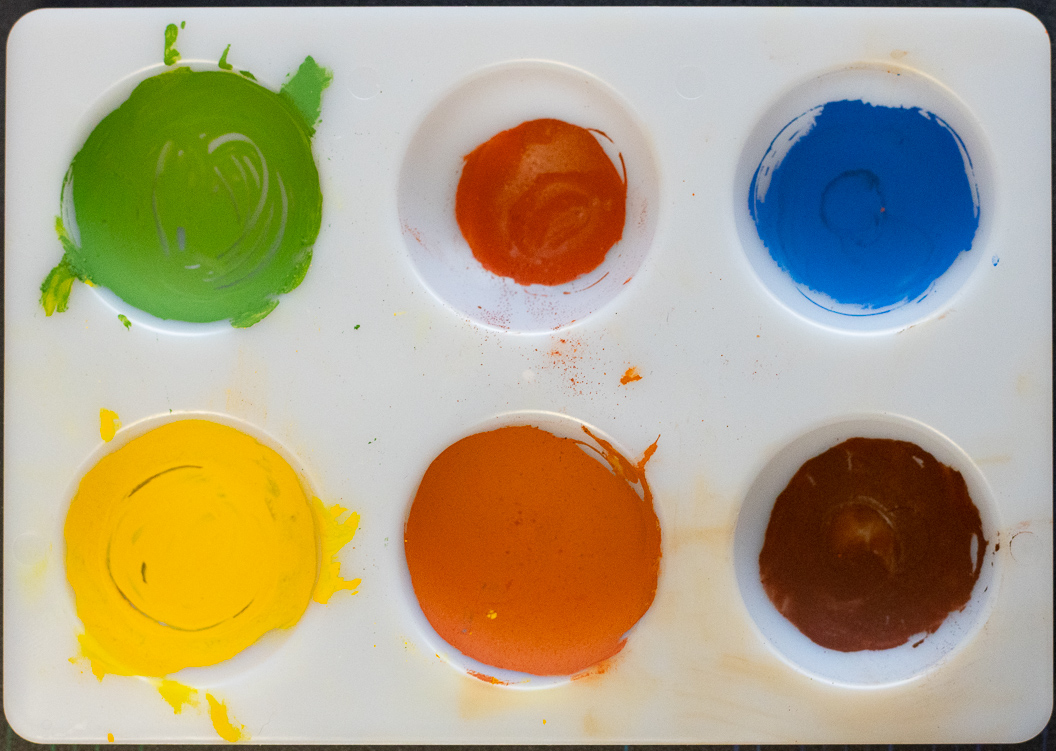

Well, for those interested. I purchased a bunch of the Gamblin solid color pigments. I finally received the Ivory Black, although I am still waiting on the Titanium Oxide white. With the black, and the rest, I was able to start experimenting.
I just made some basic guesses, but at the moment, I've come up with the following mix ratios for the colors I've been interested in. Note that, while there are official names for many of these colors, there do NOT appear to be very many official actual meanings to what those names are. Outside of perhaps Pantone, which I haven't gotten into, I've been mixing according to what I see when looking up these colors, in variations I like myself at least. One of my key references:
Teak and Natural will require a white as they are more tints of the other pigments, so I won't be able to try them out until the Titanium Oxide arrives.
Avocado Green (Bright) = Chromium Oxide Green : Burnt Umber : Yellow Ochre -> 2:1:1
Burnt Orange = Mars Orange : Burnt Umber -> 6:1
Harvest Gold = Cadmium Yellow Medium : Burnt Sienna -> 4:1
Navy Blue (Dark) = Cobalt Blue : Ivory Black -> 2:1
The existing colors for Burnt Sienna and Burnt Umber are already perfect for those vintage/retro colors, so I've left them as is. I think Mars Orange will be good for just a plain old orange, but I may try mixing in a tiny bit of Yellow Ochre or Cadmium Yellow Medium to see if I can brighten it just a bit. The avocado green is more of a brighter version of avocado green. It might need just a tiny bit more yellow to truly match the color above, but what I ended up with given the above ratios fits the eras well. You can also find darker, more muted/drab versions of "Avocado" or "Avocado Green" colors online. So far I don't have a use for those versions of the color.
Oh, and for red, the Cadmium Red is of course a perfect match for the brighter red I was looking for. There are a couple other blues I want to try...I found some interesting antique tins at the antique store the other day, one of them was a two-part ink remover solution from, we think, as far back as the 20s or 30s. It had this nice darkish blue, with black as a secondary and lighter gold accents. I will be trying to replicate that blue as well, and I am going to try to make a pen with the black, gold and blue. The combination looks so nice!
The testing I did was to mix the dry pigments in the specified ratios, then add just a tiny dab of water as a clear base to properly mix the pigments together to get a real feel for what they will look like in a clear resin.
Photo of the colors I ended up with given the above mentioned mixes:
Now, I use a very wide gamut screen...I used the sRGB mode to try and match the color on screen to the color in the actual palette, but, I don't know how it will look to all of you. Anyway...example of the actual real-world colors. These pigments are GREAT. Love them!
EDIT: Eh...in the browser, they look brighter colored, more saturated, than they are in real life. They aren't as bright as they appear here...they are a bit more muted, earthy, and do have more of a retro look to them in real life.
