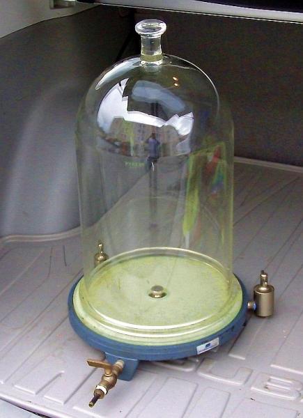

A few days ago, I posted a message in the shop area about a vacuum chuck setup for my lathe.
Now that I have a vacuum pump (Gast 0522), I guess it's time for me to venture into the world of casting, to exercise the toys... errrr, equipment.
I know that many of you use a pressure pot. However, I came across an item on Craigslist that caught my eye. The price was right, so I scarfed it up. You can see a photo of it standing in the back of my car.
It's a Sargent-Welch Pryex Vacuum Chamber.
The inside of the bell is approximately 8.5" x 15".
Has anyone used such a setup for casting? If so, is there anything special I should know about it (other than "don't drop that very-expensive-to-replace glass bell!!")?

Just make sure you have a tall container for your casting material. The rubber if your making a mold expands very quickly in the chamber and flys up your container. I use a small bucket with a lid, in my case I have a 6" round bucket by 8" tall. I then cut a 3" hole in the middle of the lid to allow air to escape. When the air is pulled out of the chamber, as I said you will see the material rise up the sides, thats why I have the lid on it, it keeps the material from making a big mess in your chamber. Happy casting
