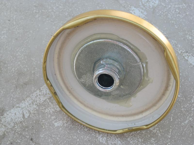

How do you attach the fitting to the jarlid and make it vacuum tight? I was going to place amale quick release on it and got some 1/2" washers, some Epoxy and a coupling to attach to the fitting. Thr cupling does not fir tightly to the washer and even if it did it will hang down a good ways and I worry about it sucking some liquid in the tube. Also what type of tube do you use? I picked up some polyethelane (sp?). Will that hold up?

What I did was drill out the lid smaller than the fitting and 'screwed' it in. I placed a 1/2" washer on top and inside all held together by some 5min epoxy. I am hoping the eopxy will hold the vacuum but I picked up some silicon to make some casting molds too so I can use that if need be.

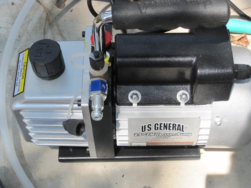

Chris which Vacuum pump from HF did you get? also do you have a vacuum gauge and know how much vacuum you are getting with the Jars?

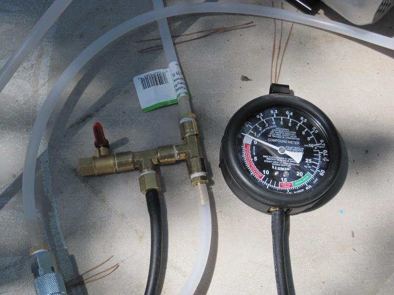

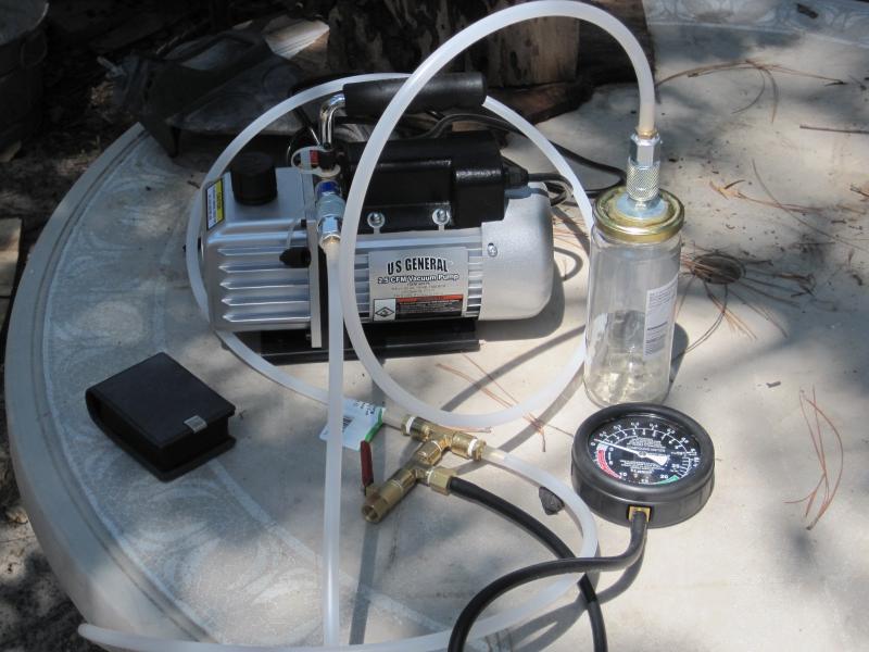

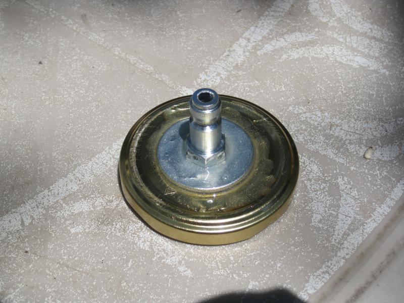

Pics of my psuedo vacuum setup
Here are some pics of what I put together. The jar is an olive jar for testing before I start punching holes in my larger lids. My hope is this will be successful and I can get a real one soon. My test will be on Pecan w/ dye. Pecan is hard as a woodpeckers lips so if I can dye it I think I would be able to dye anything.:biggrin: That is Epoxy on the lid and not caulk.

You need to put a second jar in your set-up between the pump and the way too small jar you are using to hold what ever stabilization material you are using ... I highly suggest you try Mesquiteman's "Cactus Juice!"
AND ... BEWARE of using GLASS IN ANY PRESSURE SITUATION! Vacuum is one thing, but PRESSURE is just making a potential grenade just waiting to go off in your face. Always check for scratches on any glass jar and do not use one that is scratched, cracked, or chipped.
I have great success using a LARGE glass dill pickle jar ... a gallon size. $5 or so at SAM'S. Throw out the pickles if a gallon is a life time supply and you need the jar now! You do not have to fill the jar with 'liquid', but instead have enough to completely cover the wood with allowances for that 'liquid' which is taken up by the wood, etc. A one inch 'cover' is what I use normally. Different density wood will absorb different amounts. Think along the line of Balsa vs. Oak ... unbelievable differences in absorption!
What looks to me from your pictures is that the instant you put the vacuum on you will fill the small jar with boiling foam ... and I mean instantly in that you will not be able to turn the pump off before damage is done and you and dead in the water with a ruined pump. I believe you should seriously shorten the vacuum line.
The second jar will protect your pump from any fluid that will be sucked up into your vacuum line in your present set-up. This liquid will NOT BE COVERED UNDER ANY WARRANTY you may have regardless of expense.
Also, solder any fittings you use in the lid. Much better vacuum than any washer use ... in a home-built system. You will probably need to remake the lid gaskets as the soldering heat will probably destroy most gasket material already in the lid.

Thanks Fred
To cover you points.
The jar there is just for testing. I am placing small blocks in there to test penetration and I wanted to test my seal. I didnt think of solder then but may go pick up an soldering iron and do it that way on the larger jar.
No pressure here. This is strictly for vacuum. When I need pressure I plan to pick up one of HF's 2.5 gal pressure pots
Vacuum lines length, I made them long becasue I have not decided exactly where I was going to set up yet, figured it is easier to cut them then stretch them.
I looked for the large pickle jars with no luck. Thanks for the sams tip. I dont have a card but know someone that does.
For the boiling foam, I placed a relief valve by the meter, like mesquite man recommended in his vid, and allow the vacuum to build slowly. to keep it out of the lines. I am liking the second jar and had even though of it yesterday during my first test. gonna need a jar that I ca solder 2 inlets onto. I think I have a salsa jar that will work.
For my fist test I left it in vacuum for 1.5 hours which was about 30 mins after the bubbles stopped emerging from the block then removed. That was kind of my control. Today I will add some more color since I used red and did not have much and will test again but allow to soak over night after the I remove the vac.
