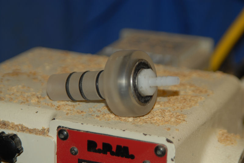

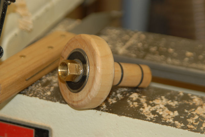

I'm in the process of making a vacuum chuck. So far I've made two rotary adaptors. A different design to the one George linked to, without the need for the lamp rod. Both of mine leak at the bearing. I'm using a double sealed rubber bearing. Any advice on what type of bearing I should be using?
They're pretty simple to make. The first I made from wood, the second from Alumilite I cast in a 2" pvc pipe.
