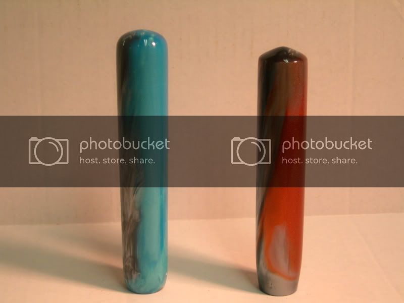

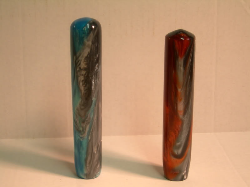

I actually use 1.5" PVC for my tap molds. Here are the first 2 I did. I have 3 more I am working on now. I need to mix the colors a little more next time but I was happy with the results.
I pour both colors at the same time. What I did on the last ones was put a skewer down the middle and swirled a little when I pulled it out. I will be turning those tomorrow so I will report back with pics to show the results.

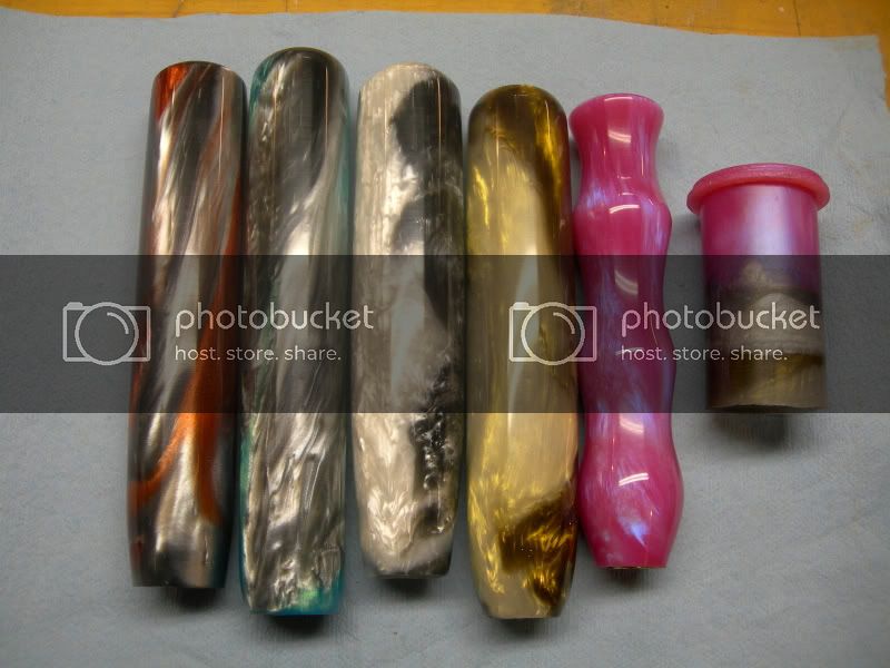

Here are a few more taps I just finished up. You can also see that I keep a mold handy for stoppers and put any extra resin into so it doesn't go to waste and provides for a funky stopper blank.

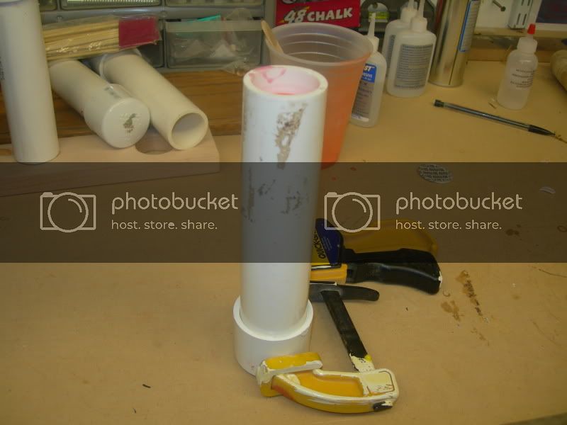

Here is a picture of the molds I use for the taps as well. I think somebody asked about that in an earlier post.
