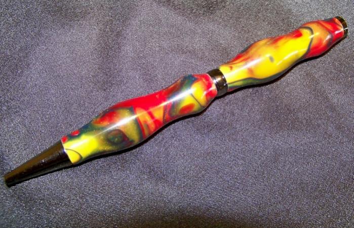

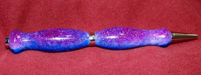

Kent, I've bought and tried just about everything to see if it'll work to color PR. The acrylic paints will eventually set, BUT from what I've done, it's not worth it. The finished result was grainy looking, lemme see if I can find a pick of the pen (this was about 2 years ago btw!) First two pics are two different "paint" blanks. The first one was your typical acrylic paint and the second was testers paint. they both took DAYS to cure. I've recently bought an oil paint set and did get a couple blanks made with it. It took longer than normal to cure, but less than a whole day. I haven't found time to spin it yet to see how it turns but the colors are nice and vibrant. You do have to be careful not to overload the resin or else it will never cure. I've stuck with micas and some dyes for the majority of my castings. Those that I recently did for you were done with the castin craft opaque dyes btw. Hope that helps any, give me a shout if you need to.
