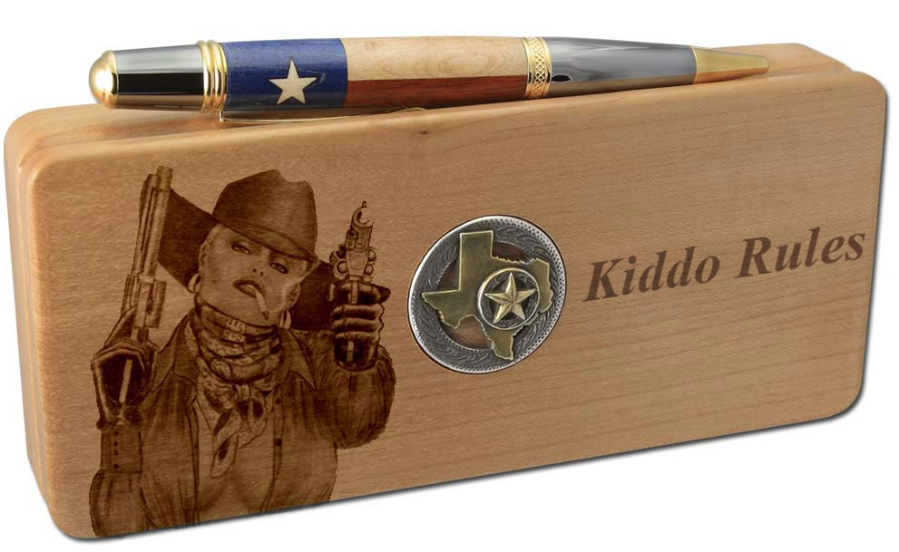

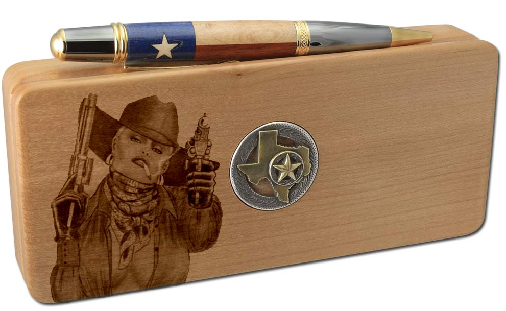

Photoshop tip for pen turners.
Ever wonder how that picture would look engraved on a pen box without having to actually try it?
You can use Photoshops linear burn blending mode to get a pretty good idea what it will look like.
Put your image on a layer BELOW the layer containing an image of your pen box and then change the blend mode on the layer containing pen box to linear burn.
The resulting image is pretty close to what it will look like burned onto the wood.
Play with the image to get it right before sending off to the engraver!
Example: pre-burn test: "Texas Pepper Spray"
