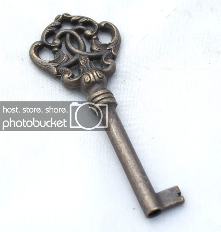

I'm assuming you mean a key that looks like this.
It going to have to a pretty big key in order to get a fountain pen nib section in there. The tubes on the kits I have looked at it needs to be around 10 mm or 3/8 of an inch and that the inside of the key not the outside. Not even sure a slimline transmission would fit. But if it does you would need to drill out the inside to 1/4" top and bottom.
But the type and size of these keys mean I don't think you can thin it down to cast it.
How about use a slimline kit but use the head of the key in the top.
Thats the kind of key I meant. I wasn't going to try to stuff the fountain pen nib and ink in the key. The fountain pen kits I've done the nib and ink cartridge fit in the lower barrel. The upper barrel was mostly empty space. I was thinking of creating the lower barrel and enough upper barrel to hide the ink cartridge, then attach the key to the end of the upper barrel.
