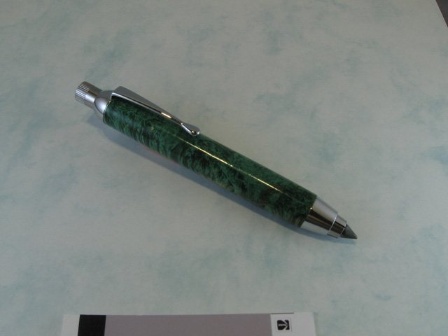

The original picture from the camera:

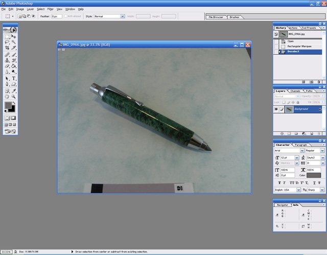

Loaded into Photoshop, note the gray card along the bottom:

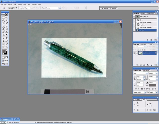

Here, I've selected the area of the photo I want to keep and then used the Level control (CTRL+L) with the eye dropper to set the black, white, and midtone levels from the respective areas of the gray card:

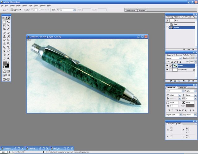

Next, it is copied into a new window. I noticed that my little stand was visible so I would use the healing tool to erase it, but I'm lazy and didn't do it for this example:

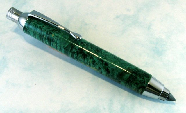

The final result of using the gray card:
