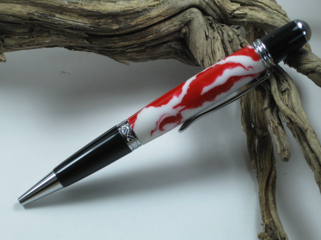

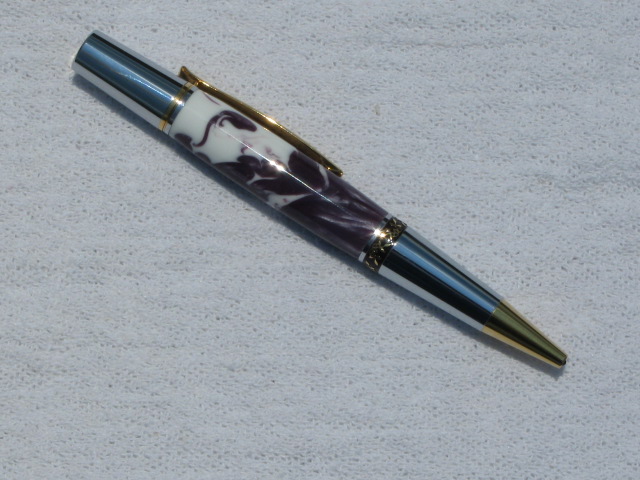

Look at Hobby Lobby and over around the glue you will see "Castin" Craft pigments. I use Poly Resin and those pigments and have never had a problem.
