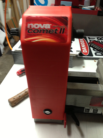

I purchased a Comet II from WoodTurningz a couple of weeks ago. I received it on a Friday evening, and was excited to get it set up and running. Much to my surprise it was very noisy and had a lot of vibration. I immediately contacted NOVA thru there website and put in a ticket for support. The tech emailed me on Monday telling me to try adjusting the brushes on the motor. I did and it didn't help. On Tuesday he told me to check the belt alignment, I did and nothing again. Nothing on Wednesday. Thursday I was told to ship the motor to them and they would look at it.

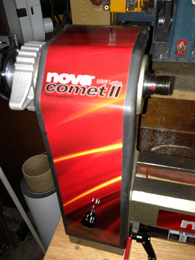

The Lathe I received is a different model number. The first was a 46000 this is a 46300. It is a newer updated model. It is also A VERY Nice Lathe. Very smooth and quiet, and the new cover motor and switch are definite improvements.
The motor has a much beefier brush housing around it than the original. You can recognize the difference because the old model had a black brush housing and the new one is silver.
The switch on the new model is now a push button and is larger and has a protective clear cover over it that protects it from water that might be on your hands when wet sanding. A Nice touch.
The belt cover now has a Knob you unscrew to open instead of a slot you needed the supplied tool to open. I thought the plastic cover on both was a bit cheap feeling when I saw it. But it functions well and does the job as intended. The design is excellent as it allows you to easily change the belts even with huge hands.
The Bed and tailstock are both well designed and work as intended. You can add bed extensions if needed to increase the distance between centers. The bed is drilled and tapped with 4 attachment points and a machined face, to assure a positive fit and good alignment.
