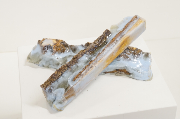

Here's my first casting of "worthless wood". Kind of a surprise. I think maybe the mix was a bit off.

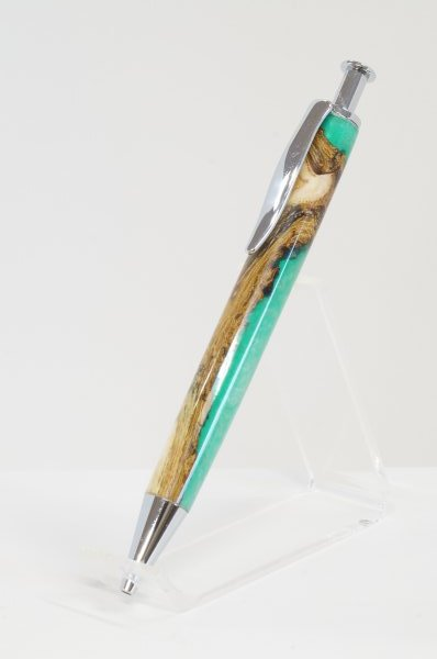

Then I tried this one. It turned out a bit better. It's Alumilite resin and some poplar chunks I had laying around (worthless). I mixed up the Alumilite in 2 batches, a "clear" with some color and an opaque and poured them together. The effect turned out good IMHO. I especially like keeping the bark on but that requires extra work to keep it from blowing up during turning or being easily sanded out of existance. DAMHIKT

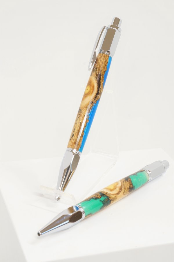

Since the Clicker turned out ok, I changed colors and tried it on a Vertex in blue. Again, not too shabby IMHO. The green Vertex is from the previous pour but didn't show the resin very well - shouldn't have put it on the back side but I was hiding an imperfection with the clip.
