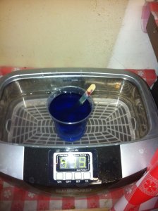

If you go to Penman1's photo:
you will see the Ultrasonic cleaner in action.
They heat the resin in the U.C. What I did was put hot water in the cleaner and floated the the premeasured resin in a cup to heat the resin and remove the bubbles. I bought the cleaner with the heater just to have if ever needed and the extended waranty because I read they didn't last long. I never saw many bubbles when using it so I stopped. The ones I know that use it have been doing it a long time and are good at what they do so the last thing I want to do is question their thinking. I measure the resin in a cup and place the cup and the mold in a toaster oven set at 100-120 degrees for 15-20 min. depending on how much resin I'm heating. When everything is warm I add the mepk and gently stir so not to add bubbles and pour the resin in the mold. I use a small guage wire to get the bulk of the bubbles out from stirring and pouring then put the filled mold back in the oven for an hour. I let set several hours to cool and set the break down the mold and let cure a few days before turnning. Good Luck.
Okay, for some reason I thought you put the molds in the cleaner after pouring. Just the cup of resin before pouring makes more sense.
I have been using large (9 oz) paper dixie cold cups. For the 8 minutes I have them in the ultrasonic cleaner they seem to hold together great. Although any longer and I can see the seam could start to come undone. :)
