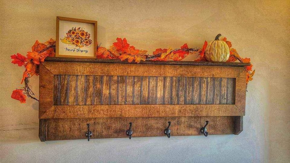

First, I have some requests from a few friends to make some of these concealment coat racks, and I think I can do better than what I'm seeing on my local FB Marketplace. After I get these first ones done, I'd like to make some example pieces in a couple of different finishes and put them on FB and see how it goes. Unlike the first image below, I'll be using solid pine boards for the sides, top, and door frame pieces instead of plywood, although I'll use plywood for the back.
Can you guys give any advice on how to give this piece some love? I'll definitely be routering some of the edges but I could use some direction on which edges and what bit. It seems like the 4 door frame pieces could use some kind of design on the flat faces, but I'm not sure what that would be. Stencil or router work...dunno.
Also, if you have any other suggestions as to how to make this an overall better quality piece, I'm all ears. For example, I've seen videos of these with winey sounding RFID locks. Cool function, but it sounds like crap. I'd much rather install a some kind of magnetic switch, although I haven't found one that would work for this application yet.

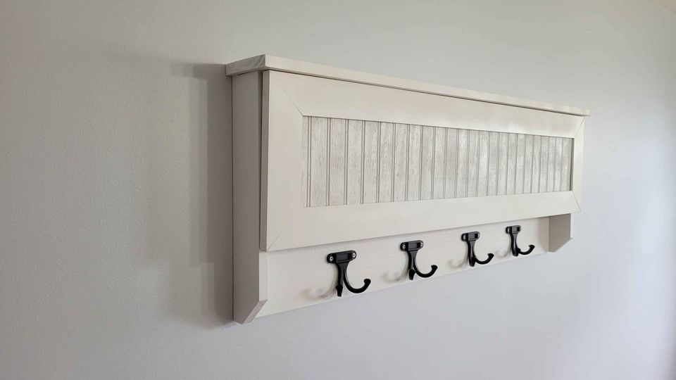

On design...thanks for pointing out that the bead board is the highlight. That'll keep me from overembossing like I've done in the past. Could you explain more about adding a bead around the door frame though? Sorry, I don't have a lot of experience here, and I'm not able to picture it that well. Insofar as the white painted example above goes, the only addition I have thought to add that wouldn't be overkill is to add a VERY slight 45 degree chamfer to each of the boards corners, just enough so they're not sharp edged. Also, I might 45 deg chamfer the front underside of that top board as well, as indicated by the red triangle on the end. If it's not apparent in my rendition, the top of that triangle doesn't go all the way up through the thickness of the board, so they'll still be a small flat part on the top front edge, maybe about 3/8" tall.
Thanks for the branding iron advice Drew. I've seen that in the past but had forgotten about branding that way.
EDIT: Oh I see you found where these are gun concealment pieces. Yes, no I'm not so much on concealment myself. It's just what sells around here from what I've been told.

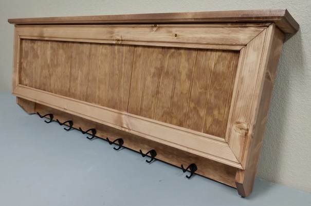

EDIT 2: I think I found the style I want...
