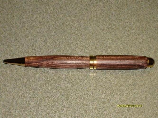

This one just came off the bushings from Johnny.
Absolutely no ridge between the nib and the wood.
The bushings are worth every penny, thanks to Johnny and all his salesmen. I am still having a problem with the ridge but it must be the alignment of the head and tail stock so I make sure that when I turn the nib end it is at the head stock. That has cured my headache. Anyone want to buy a bunch of used, bent, worn out mandrels[:eek:)][:eek:)][:eek:)]
