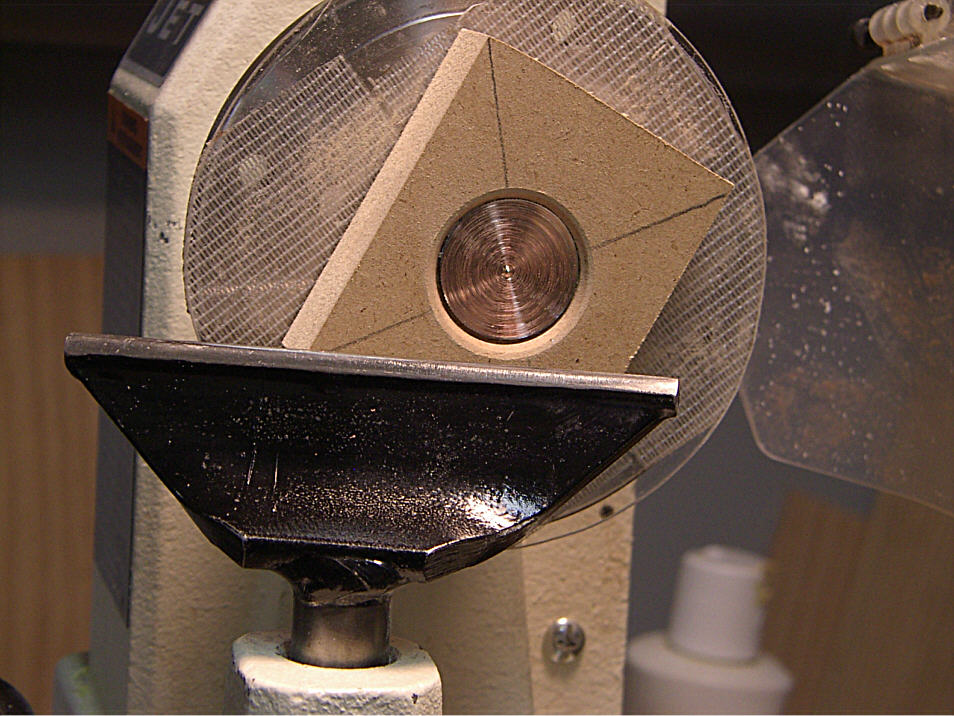

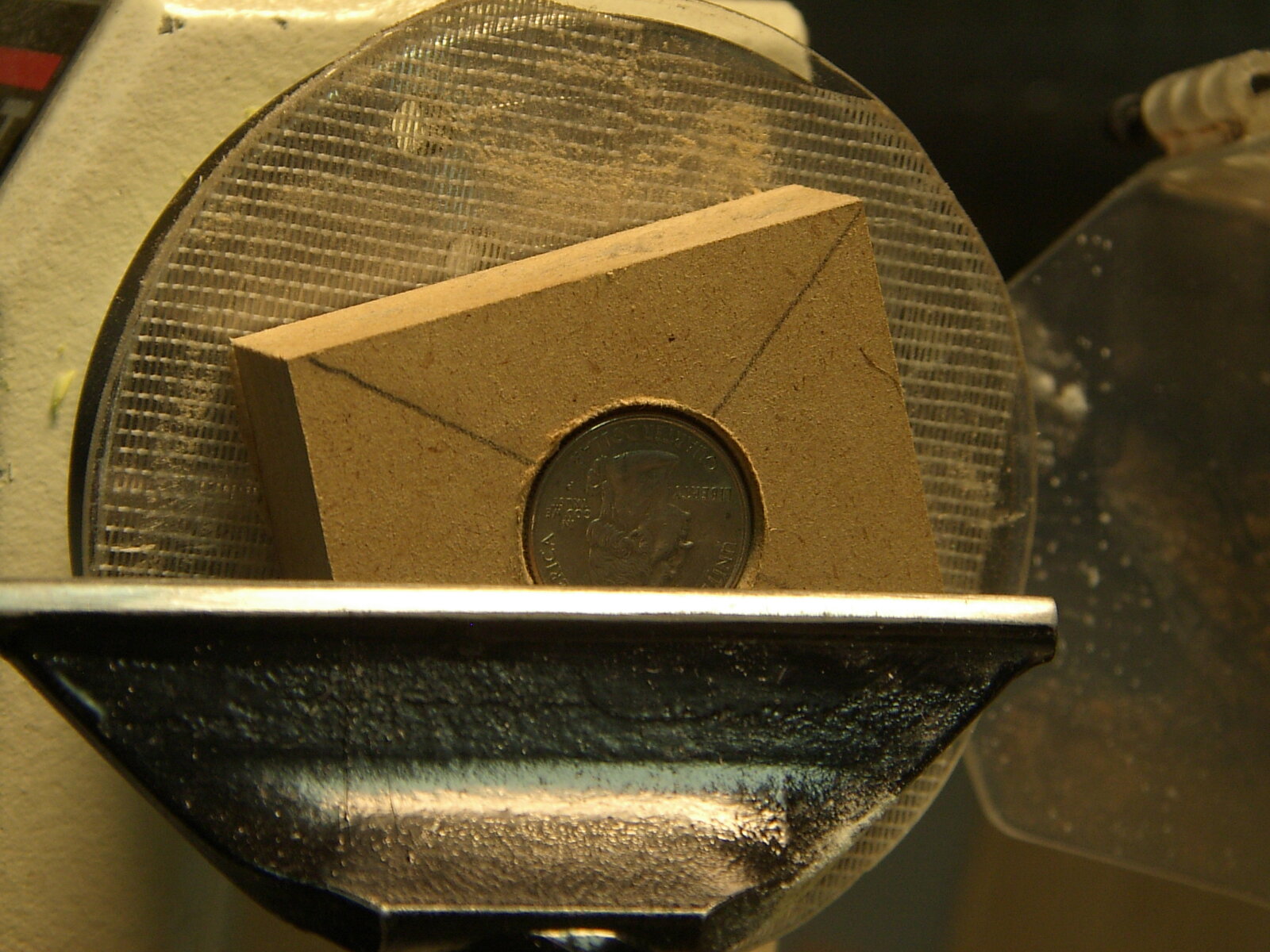

Just to piggyback off what Louie was saying. Carpet tape as you can see here is holding that acrylic face plate as well as the block of MDF that holds the quarter that I was thinning down. This did a couple things. It kept it from wandering off and also helped center. You can easily use a live center to help support the pressure toward the faceplate because you object is larger than a quarter. It will not get in the way but if it does the tape should do fine alone. I would make the groove first to keep the support and then cut the final circle with light cuts. You can build a jig like this with scraps of wood. I happen to be using a round object so easy to drill a hole. Good luck.

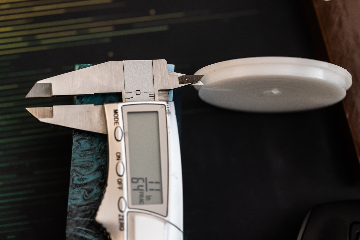

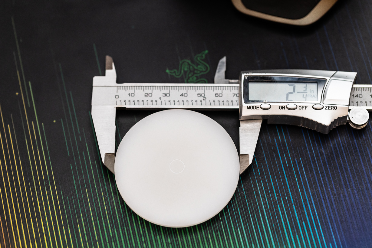

Double sided tape did the trick. I forgot I had some high performance double sided tape that was thin (not foam based) that I'd bought from Rockler about a year ago. Taped one of the HDPE blocks to a piece of sacrificial wood, brought up the tailstock with the only flat-tipped live center I had, and was able to turn it fine. Once its stuck to something, HDPE is amazingly easy to turn. I think I turned the lip just slightly too thin, so I may have to turn another, or maybe find a way to shim this one with pieces of tape or something under the rim, not sure. But I was able to turn this to exactly the right diameter.
I think I'll be double-sided taping this to another piece of sacrificial wood so I can cut a slot about 5/8 of the way through (that seems to be where the blade sits, about 5/8 through the hole. There is also this little set screw that I believe is intended to keep the plate from twisting in the hole, so I probably need to use a square to drill a small notch 90 degrees from the slit.

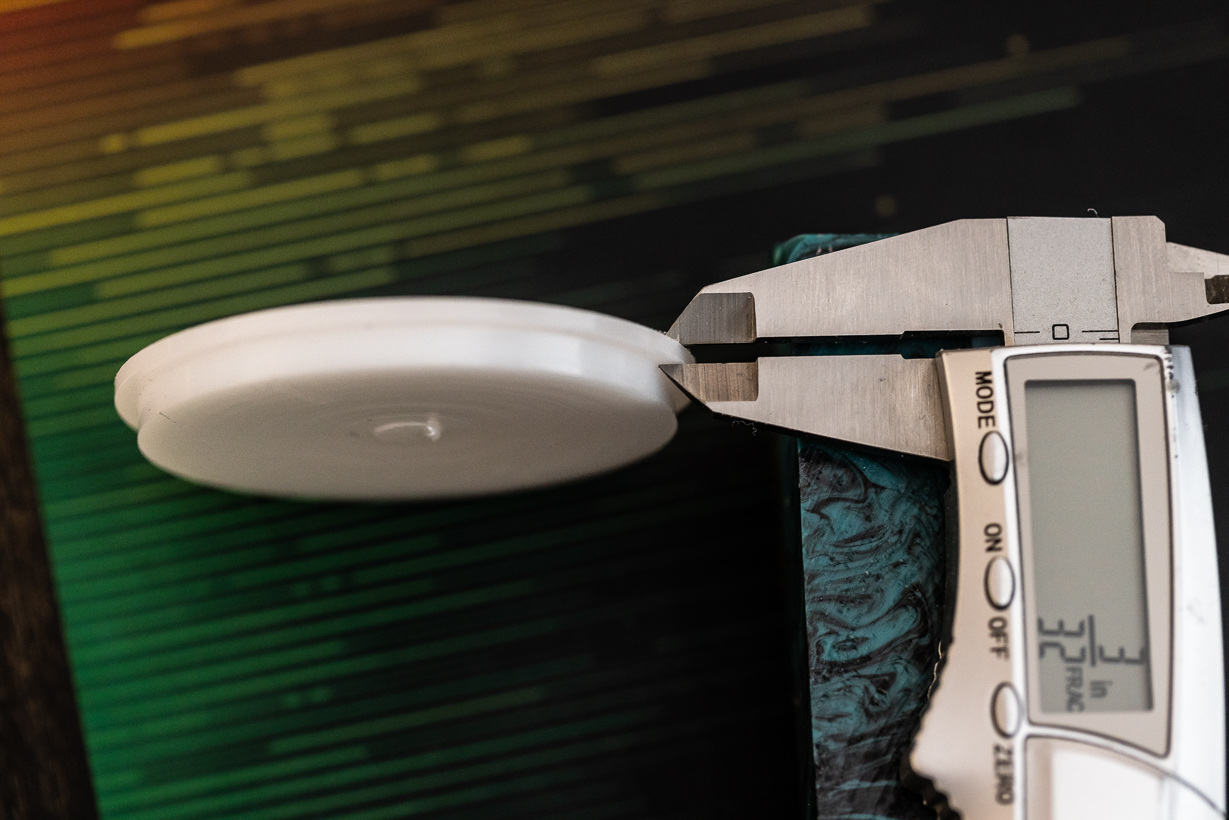

So...I did turn the lip too shallow, by about 1/32nd I think. I had it exactly 1/8th at first, but I think when I was turning the diameter below the lip, I must have been shaving off bits of the lip as well.
Is it a waste of time to try and build up some layers of tape or something to recover that 1/32nd? It took a good bit to try and carve a notch for that set screw... I'd like to not have to do that again, but if its the only real way to resolve the issue, then I have 9 more 3x3 plates of HDPE to try with.
If it was me, I would try a few bits of blue painters tape under the lip. Then in a few days I would probably re-make it. It's just me. I always wind up even making my jigs over so I can correct all of the things that I had to patch up the first time. - Dave
