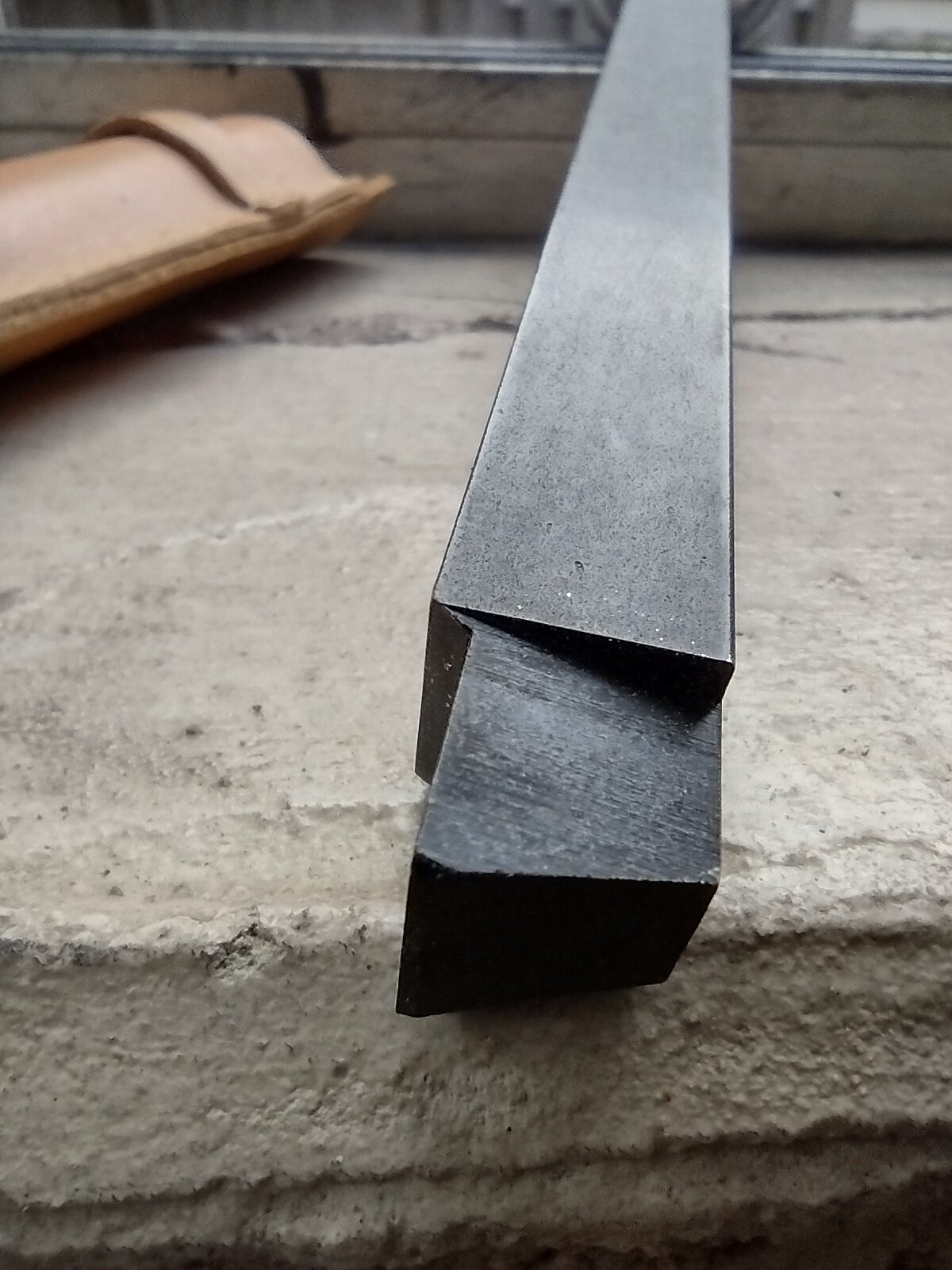

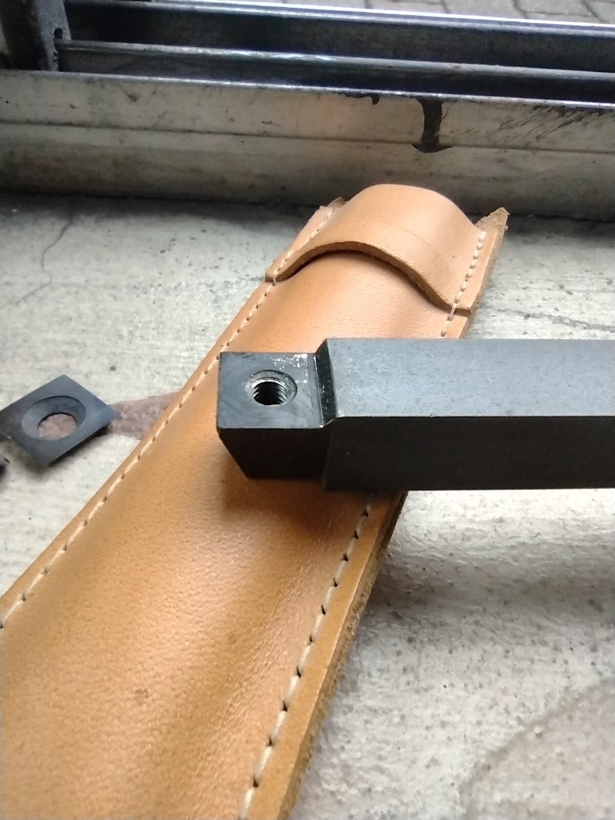

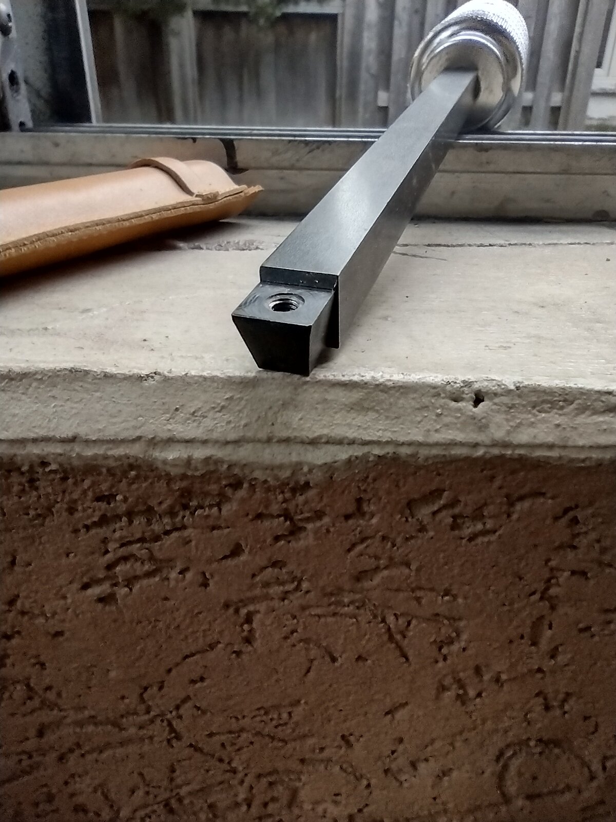

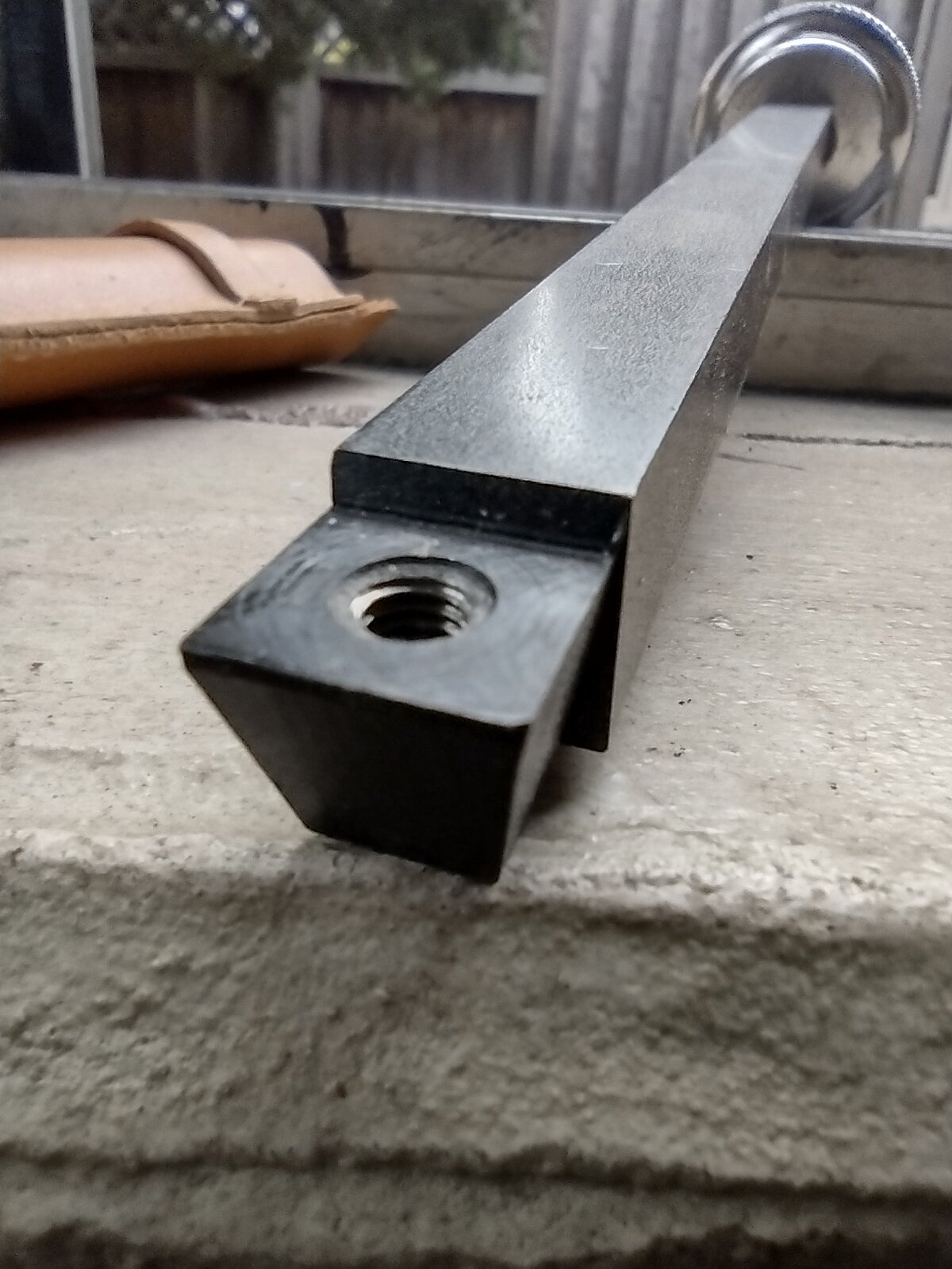

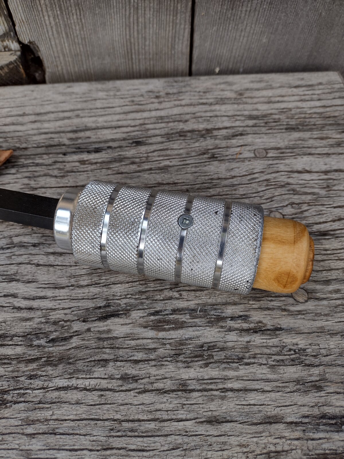

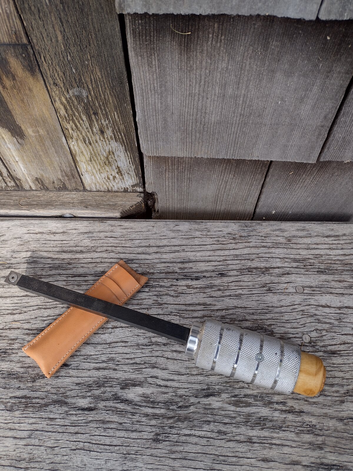

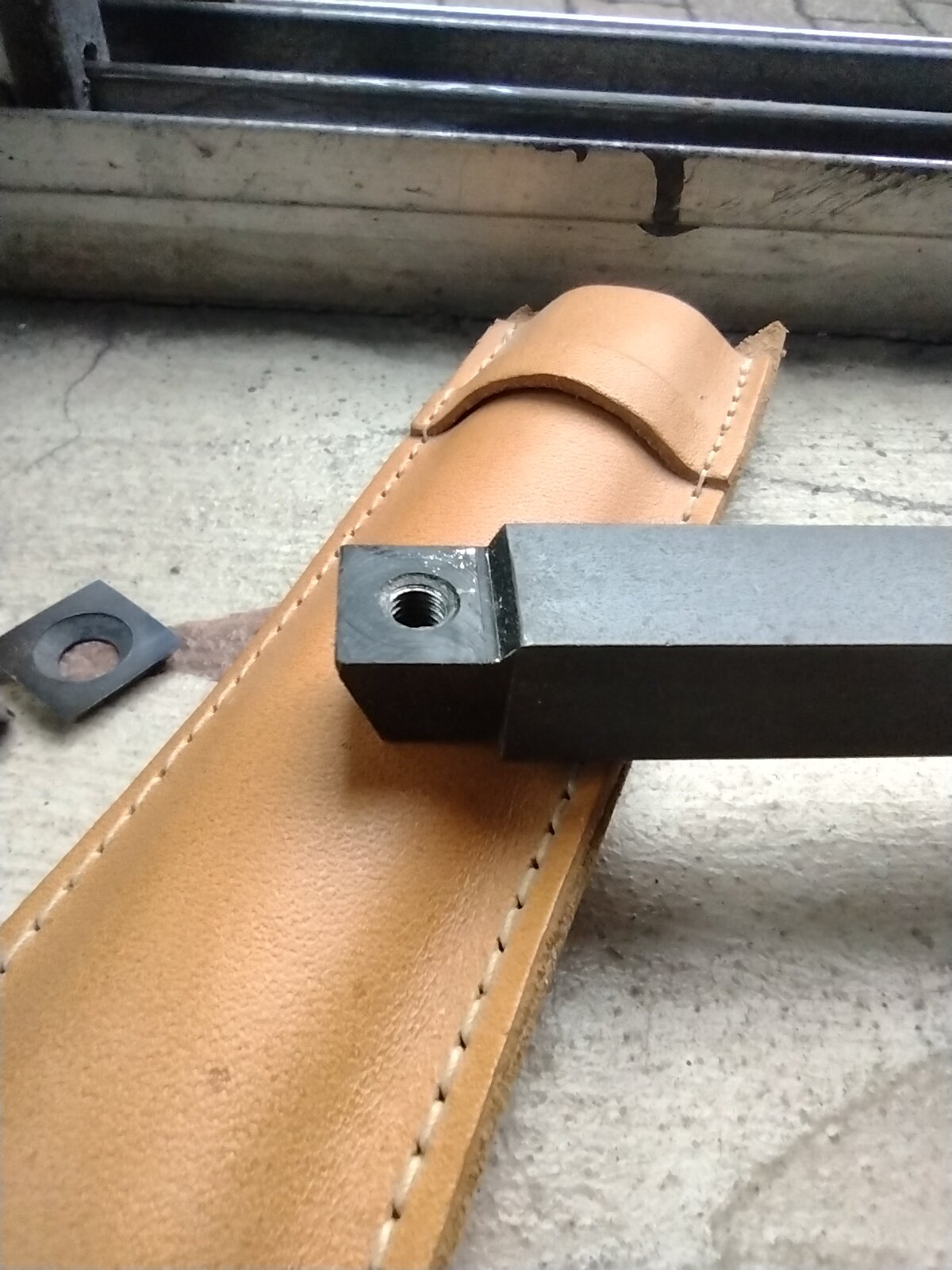

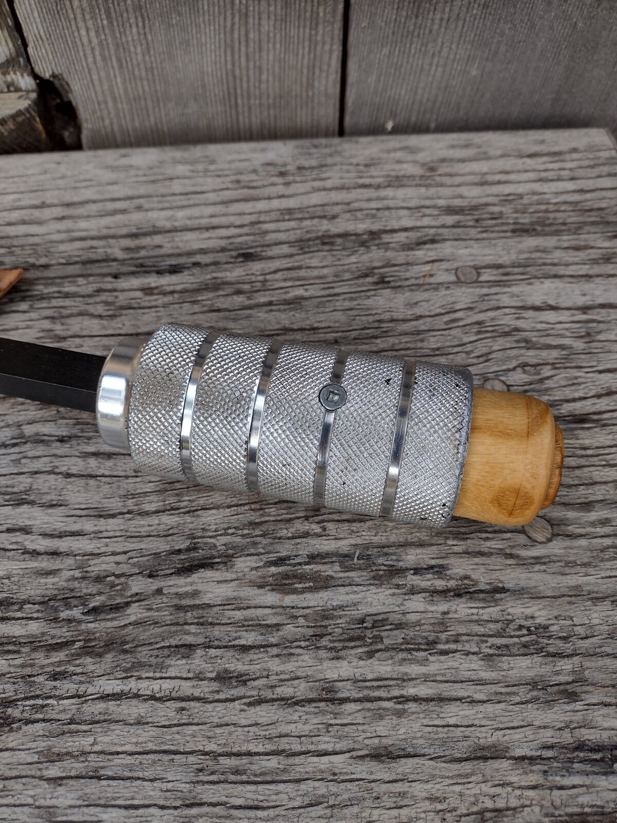

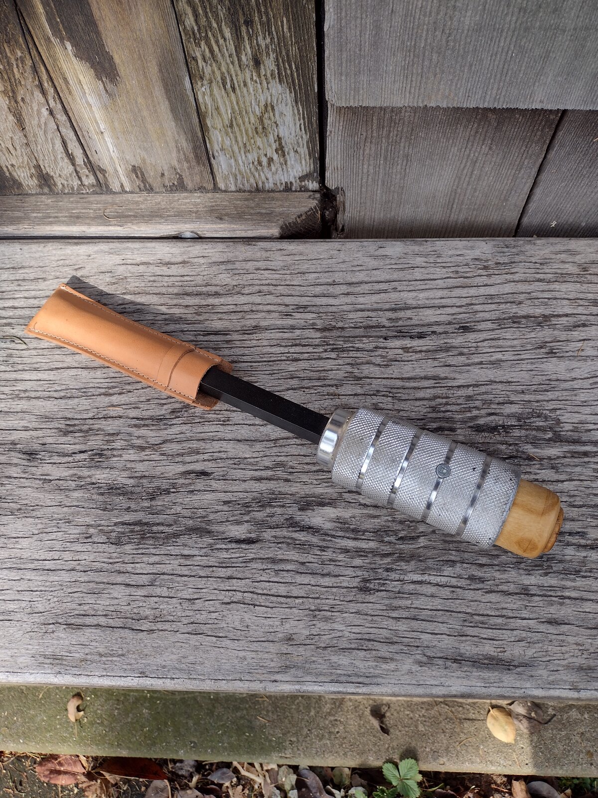

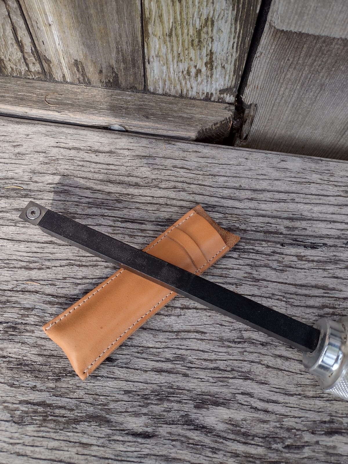

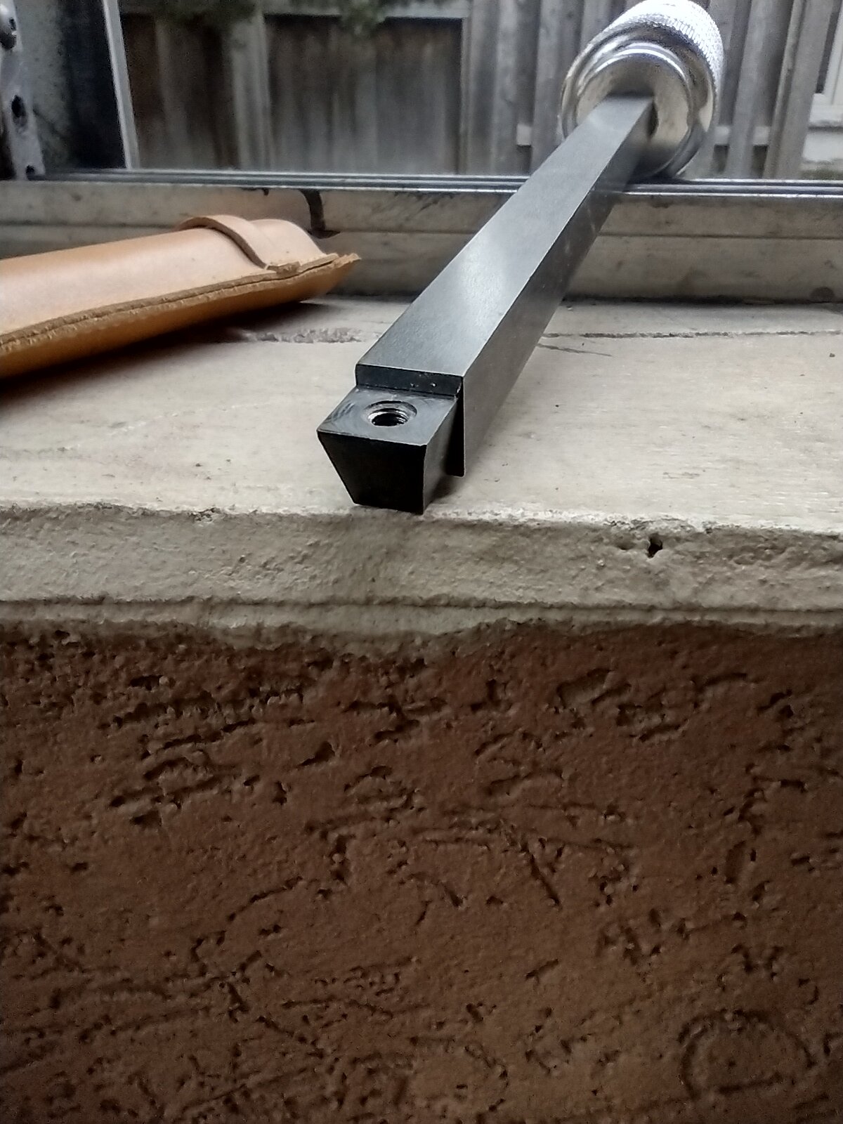

I recently completed this personal carbide turning chisel. Utilizing 15x15 mm R6 solid carbide insert that is mounted on a machine tool (black oxide)
frame. You will notice the textured aluminum oversized handle and the interior mounted wood turned handle. What I have done is basically created a
handle within another handle. This was done to minimize or at least reduce tool vibration, especially when turning larger spindles. For a larger tool, it is not very heavy but still feels solid. Feel free to ask questions or simply leave a comment if you care to. Thanks.

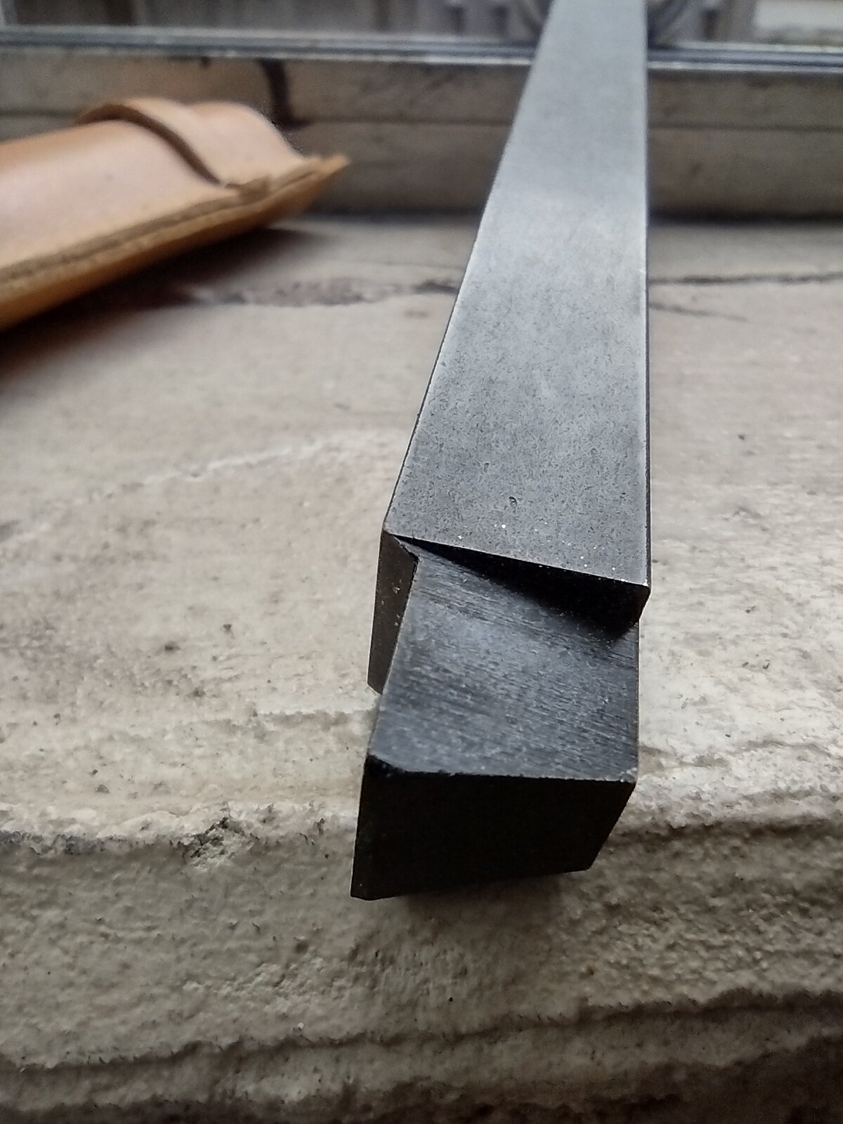

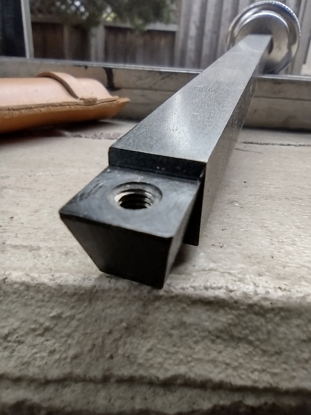

Can you show a close up of the tools tip? I would like to make a similar carbide holder but i am thinking about inox steel. Is ordinary steel better for this?cheers
