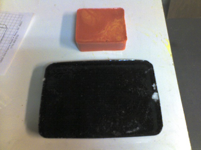

Thanks for the input - got my 1st casts done
Well - The 1st cast took over 2 days to cure. It is the dark one. I finally put the mold in front of my heater in the shop and that did it. I don't think I put enough hardener in it and it is quite translucent. I was going for green and got yuck. The 2nd one came out in less than 2 hours and I think looks much better.

Jeff, don't discard the YUCK casting. They may surprise you! The best casting I turned out looked like garbage out of the mold, but made my best pen yet... :smile:
Casting is clearly an art of trial and error- but you never know what one will turn out like until you turn it.
I've been turning round between centers, to see what surprise is inside, then if it looks worthwhile, I'll drill it out and tube it up.
-Doug

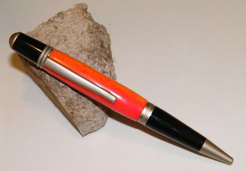

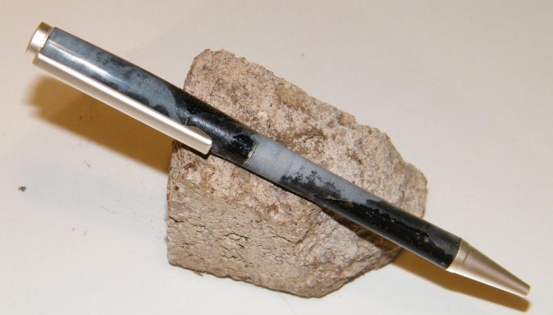

Well here are the finished products.
Made a slim from the ugly blank - my wife loved it.
The 2nd is a Sierra - the yellow mixed a little to much with the red so it is kind've orange/red with a little yellow. Hard to show that in the picture.
All in all I am happy with the results and enjoyed the process so will probably be working on some more casting.
