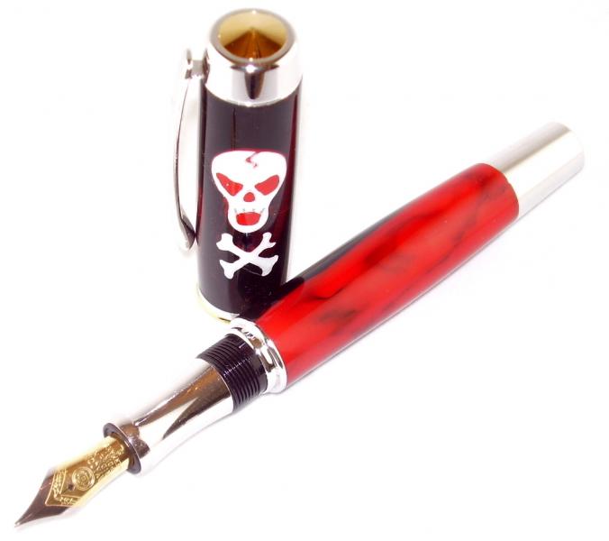

My Olympus FE-110 didn't seem to get enough white light, so the Cord Camera guys sold me a couple of blue bulbs about a month ago. Just got brave enough to try them and it seems to have helped. Just cropped this one and edited out a reflection.

I agree, blue light globes are about 6000Kelvin, why not use 4100/5100Kelvin CFL's in 22-24 watts.
They would be a lot cooler (in real temperature) to work with.
Also agree that the highlights are a bit washed out, ie overexposure.
Isn't pen photography one hell of a learning curve?:wink:

I'm not sure why you would want blue light bulbs, but the photo is over-exposed by about probably a full stop.

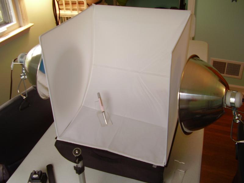

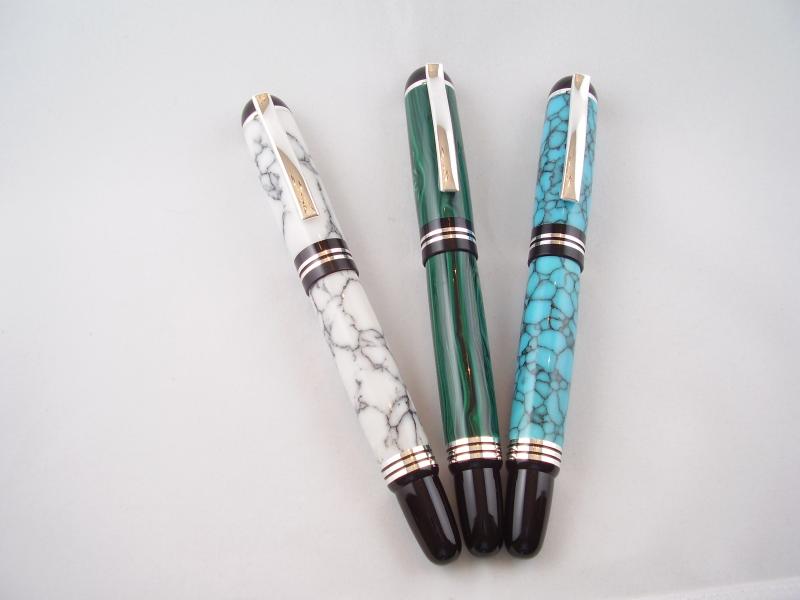

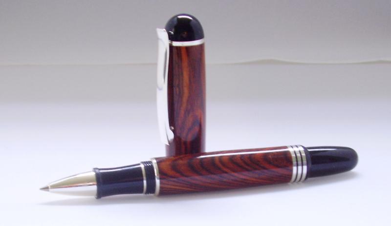

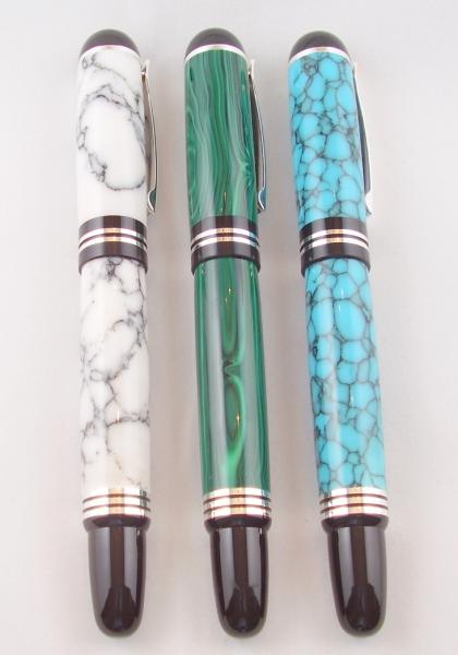

Here are a couple more pictures and my set-up. Any constructive help will be gratefully received.:smile:
