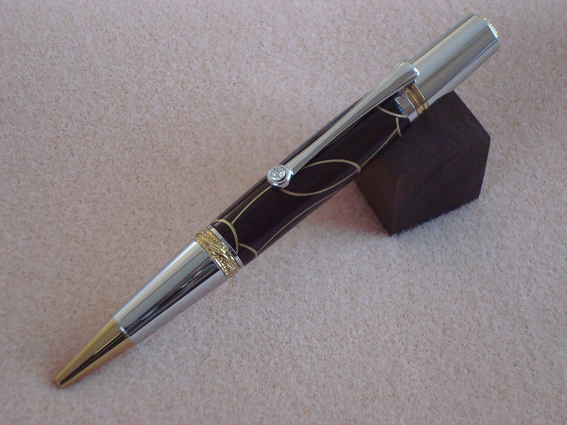

When I first started turning a few months ago, I came across an article in the Library by David Washburn A.K.A "djwood1" about curved metal segmenting. I really wanted to try something like this so followed the tutorial and came up with my first crack at segmenting.
My next try was after reading about scallops and thought I would add the two lessons together for my entry into the Beginner's Pen competition for this year's Bash. I used Ebony and brass and flipped the Ebony over to end grain for the scallops.

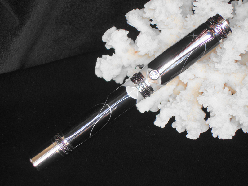

I then tried black Ebony and a white pearl acrylic on a Majestic. The aluminum is some left over roof flashing that I had been saving in the shed for years.

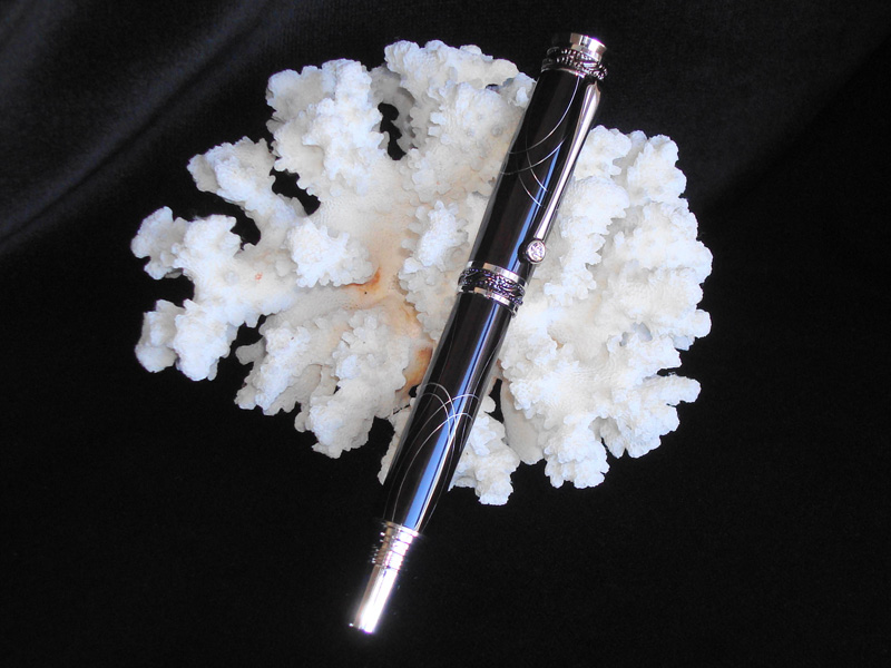

For my latest effort, I dropped the scallops but doubled up on the curved metal segments.

Very dynamic work! You've got a great collection of work here with an amazing understanding of the segmenting/scalloping process. Keep them coming
Thanks Tom. The first tutorial I read was David's, the second was yours. Thank you so much for sharing your knowledge and inspiring beginners like myself.
Mike
Wow........every one of those pens is a winner.
The word that comes to mind for me is -- classy. Great work.
Did you go straight from the skew to finishing? Are they done with a CA finish?
I had to coax Dave into writing up that tutorial, and he did a great job of it. You've made fine examples of what can result from segmenting. Nice work!
Mike; You seem to be a fast study, and an excellent pen maker for just starting not to long ago. Exquisite craftsmanship. Your photos are sharp and clear, but the coral takes the eye away from the pen itself. Just my $.02 worth. Congrats on the finish in the contes. Can,t wait to see what you take on next. Jim S
Thanks to all for your comments. Both the scallop and bent metal segmenting are so much fun to do and one design leads to another and then another. I have so many bouncing around in my head, can't wait to get back to the shop...

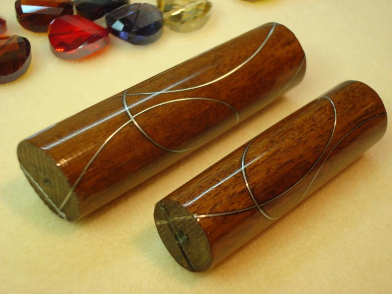

Dan, all these have been finished with a CA finish down to 12,000 MM. Despite having my skew sharp enough to cut my fingers, (DAMHIKT) I would put it away once I got close (sometimes not so close) to final dimension. It seems that these little guys have a tendency to blow up in your face when you push your luck too much. Many hours were spent re-making the blanks or on my hands and knees looking for tiny parts. The saving grace for most of these was that I was using Ebony and the fine pieces of aluminum wouldn't muck up the blank so much. I discovered the bleed over problem while working on the one that I used a white acrylic for the scallops. I switched back to the skew for that one but the Pucker Factor was way off the charts.
Thank you for your advice on the photos, Jim. I had used the coral because there were so many hooks and branches on it that you could position the pen pretty much any way you like. Might have to rethink that...
