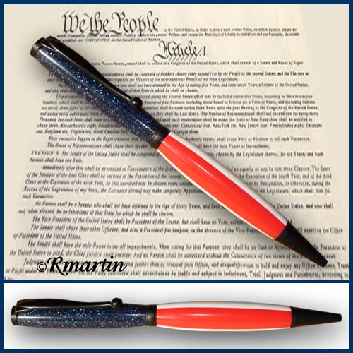

Like the others have said, only a "slim" slimline will fit in the shirt sleave pocket. I have a special on my site where someone buys a freedom pen, I donate a second one to a soldier overseas in their name through the Freedom Project. The last I looked there have been nearly 200 thousand pens donated. Here's the design I use:

Hey Rob (I think)
I LIKE your design, mine will have a white centerband where yours is black.
Also, I will use chrome hardware - I would think the black enamel would scratch off too easily. THIS IS NOT A CRITICISM, merely an observation.
Thanks for showing your design, I'll show mine next week, when I get to turning.
Another side note Ed, you mentioned the clip on the slimlines being weak. I have found that the clip on the standard flat clip SL to be weaker than the Premium SL like Rob (you think) has pictured. The beaded clip to me seems to be at least twice as strong as the standard SL. They hold much tighter to the pen IMO. This may be something to consider when making them also. Jimmy at Woodpenpro has Gold, Copper, Chrome, and Black Ti on sale for $1.55 right now. I use these and love them. The CB fits way better than the standard flat CB of the regular SL too. I will probably not order any more of the regular ones, and just use the Premiums from now on. You can see some examples of what I have done with the Premiums if you check my posts. HTH

Hey Ed, it's Richard, not Rob...no harm no foul
You're right about the black enamel wearing off. I also have some satin ones; they don't hold up much better. Once I run out of the ones I have, I'm switching to chrome. As you can imagine, the stripes are a bit tricky to drill dead center, so I might start using red and white color bands. They look nice too, and I can get more of them made and given away.
