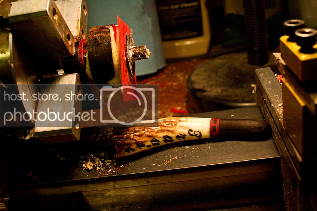

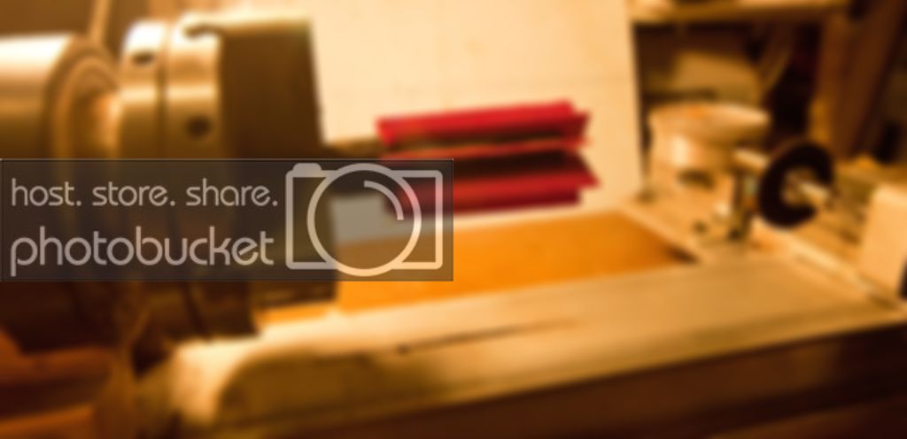

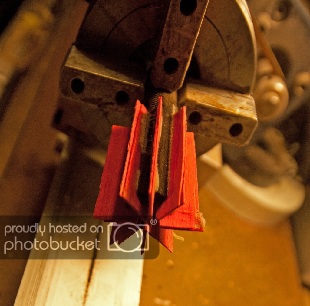

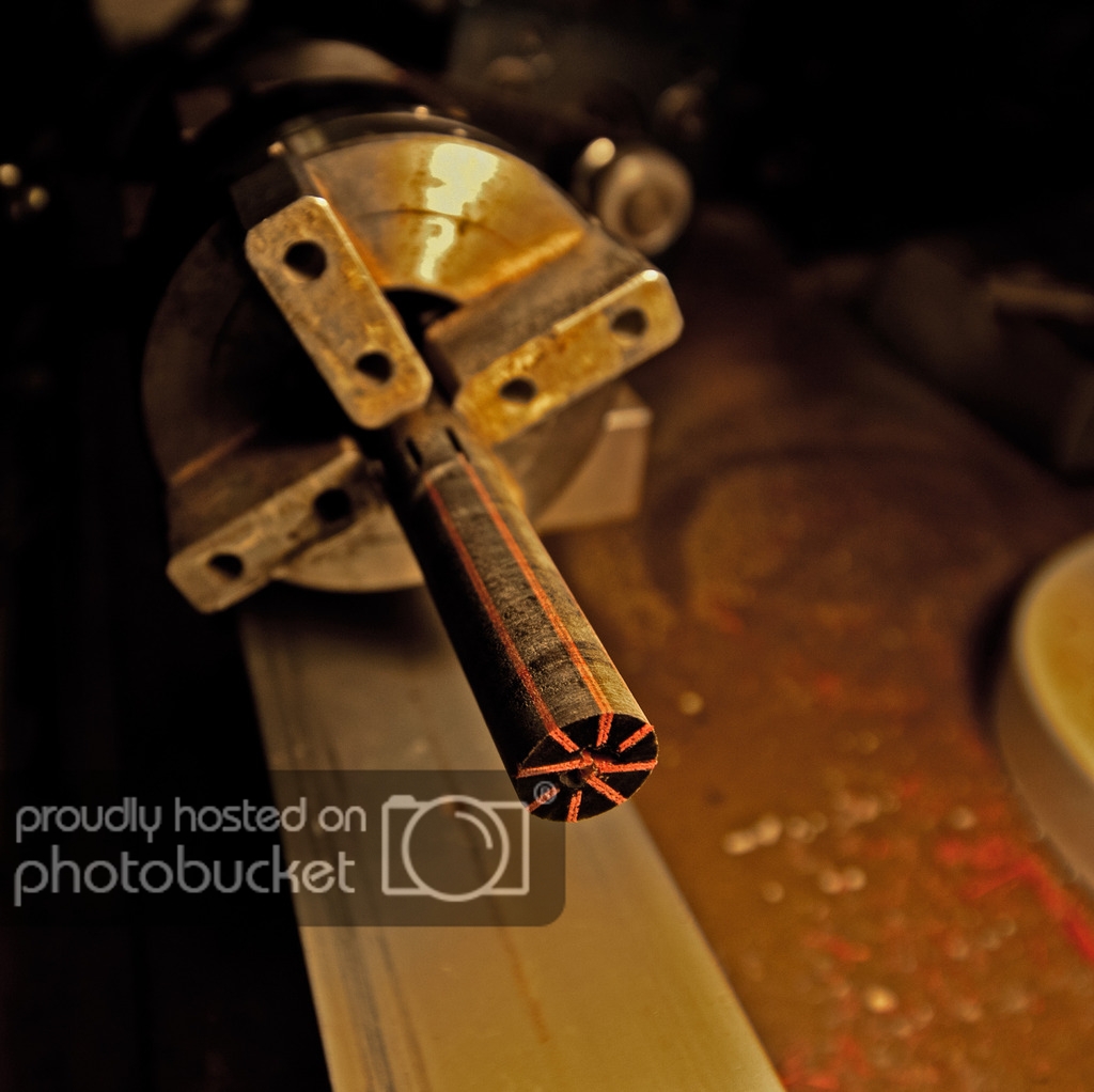

Please note that the slots were cut all the way through the wood.
I would cut a slot then glue in the veneer's and repeat process .
The whole in the center need to be re drilled .
I PUT HOSE CLAMPS ON , then sprayer accelerator in side the hole and drilled the hole out extremely carefully.
The glue being drilled out split the fluted wooden tube.

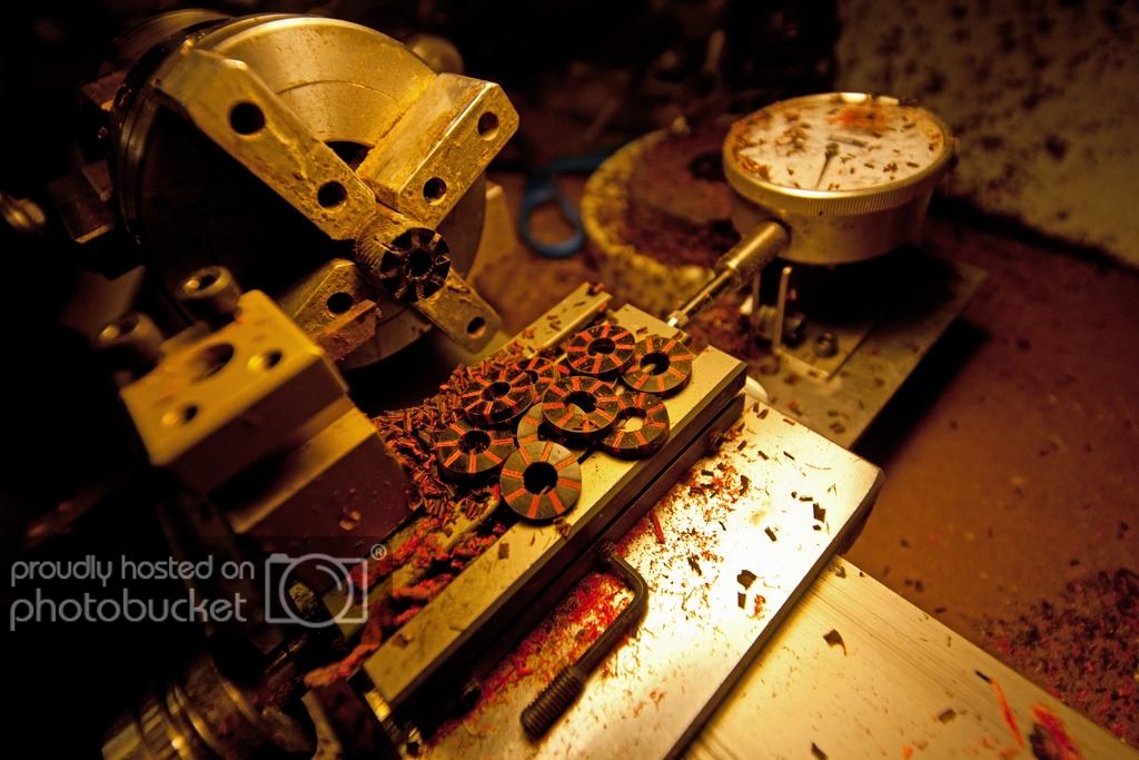

Be careful to only drill out a inch then part off a few rings and drill out another inch.
