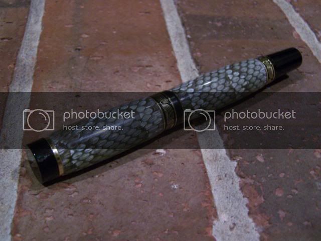

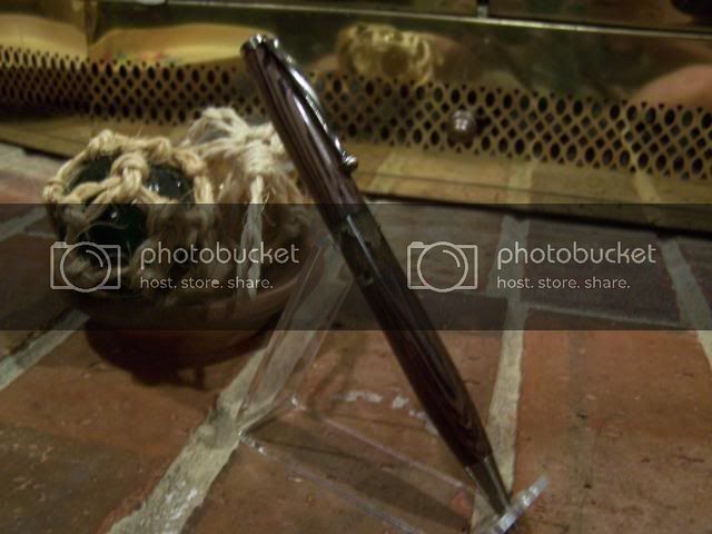

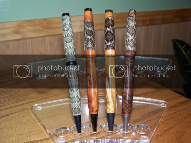

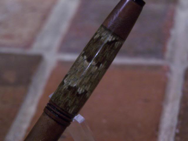

Instead of using micro-mesh, and scratch removing polish, I sand to 600 grit and use Minwax Wipe on Poly.
I use it on my snakeskin blanks. I put some poly on a clean soft rag, rub in circles, then wipe the excess off by lightly wiping the length of the barrels. I think it does a better job then sanding and polishing, it not only removes the scratches, but fills them in completely.
Remember to leave them sit for awhile to dry before handling.
^Hmmm... put me down as skeptical on that finish, but I'd love to be proven wrong! You have any good pics close up?
This is as good as it gets for cloeups, I don't have the camera for quality up close photos.
They do look good but I'd suggest a side-by-side of a MM finished and your process.
I've already compared the two. I no longer have any pens that have been done the MM way. I'm quite convinced with what I'm using now as being as good, if not better. AND CHEAPER.
Not to mention it works out real good when you're using multiple mediums for pens, like wood laminated with acrylics.
