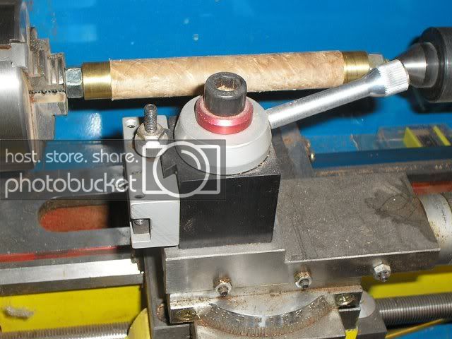

BUT and it's a big BUT...unless you can get one that is a direct match to your lathe, you will probably have to do some work to fit it. This can be tricky for a novice. Google QCTP fitted to your machine before buying.
I still need to resort to my old square head when doing parting cuts as I can't get the new QCTP low enough with the tools I have. No biggie because I didn't permanently alter the existing topslide bolt and it only takes a minute to swap them back.
Of course until then, a great set of shims can be had by buying a cheap set of feeler gauges and taking it apart. :wink:
Here is what I did to fit mine
http://www.penturners.org/forum/showthread.php?t=51841&highlight=charlie
