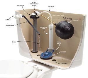

missing hose?
In the plastic riser pipe at the top there should be a small hose coming from the center of the pipe to the float/fill valve. if you have a jet of water shooting into the tank then the hose is missing. The hose directs the flow to the rim until the tank fills. The tank fill is usually slow and from the bottom of the fill/float valve.
Dave

Dave - The little hose is in place and goes into the tube like the picture shows.
