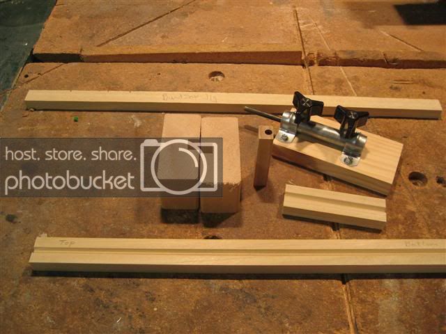

Disc Sander for Blank Squaring
I just started pen turning and reviewed quite a few opinions and methods / jigs to square pen blanks. I liked the disc sander approach ... and ... I have a disc sander that I want to use because of sunk investment in it. So, I opted to go with my disc sander. The homemade jig I chose to make is described in the following hyperlink.
[FONT=&quot]http://woodworking.com/forum/archive/index.php?t-29271.html&[/FONT] ... see comments by WoodMangler
Pictures at ... http://woodhelp.com/SquaringJig3.jpg and http://woodhelp.com/SquaringJig1.jpg
I use a small 2" engineer's square to align the transfer punch rod vertically and horizontally square to the disc sander surface each time I do a batch of blanks. This squaring alignment is done with the transfer punch rod mounted in the jig and with the jig snugged up against the disc sander table miter gage. This ensures that the blank ends are squared relative to the tube shaft and not relative to the sides of the blank. It's a quick set up ... 1 min max. Then just slide the blank over the transfer tube installed in the jig, snug your jig up against the table miter gage, slide the blank over the transfer punch rod, and gently push up against the rotating disc and rotate the blank 360 degrees to ensure uniform sanding over the whole blank end surface. Lift the jig up from the sander table regularly to check on depth of sanding ... stop sanding when you first see a shiny end of the brass tube. The method is very repeatable and sufficiently accurate for the task.
Here's a picture of the simple jigs I made to get started in pen turning. My pen blank squaring jig is shown on the right side.
Tom
