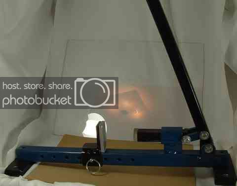

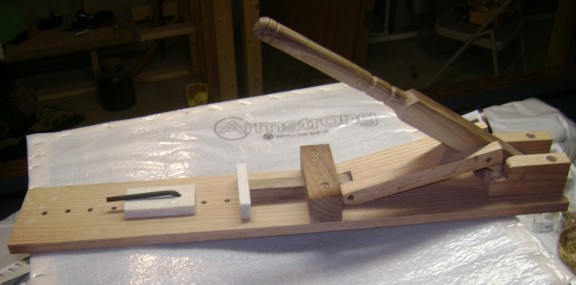

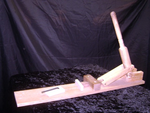

My pen press.
I have used many different versions. But this home made pen press is my favorite.
Attached is a couple of pics. And a diagram in .doc format.

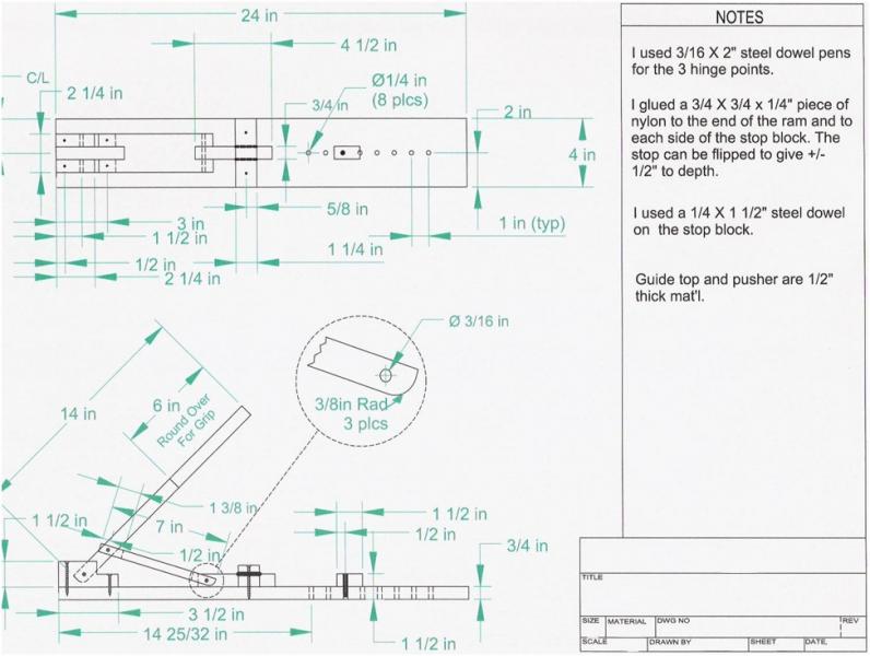

plans here.
Oops. Here is the plan/diagram for the Pen Press.
