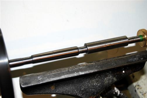

grouphug.gifI'll be darned. i have been using too high a speed. I am all for the hack saw and lowering the speed on the lathe. I had that sucker going so fast, lit sparks were flying. I think the only thing I can do to keep it cool on the lathe is to dose it with ice water. Gotta cover the lathe so that it does not get wet.

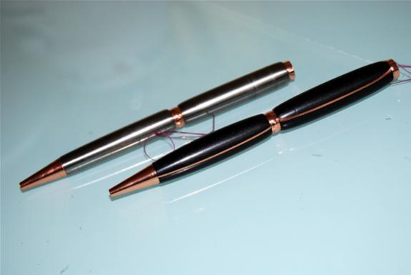

I checked your web site. There is no way I could compete with your fine work but your advice on working the Titanium "cool". I'd love to be able to add a color by some how cutting a grove and filing it. More imporatantly; what does heat (butane torch) do to change the color of Titanium? Here is my first Titanium pen so you can see that I am no competitionTi - Pen hfstf.jpgTi Left 80% turned.jpgPens - 3-23-09 Titanium-Ebony and copper.jpg.
