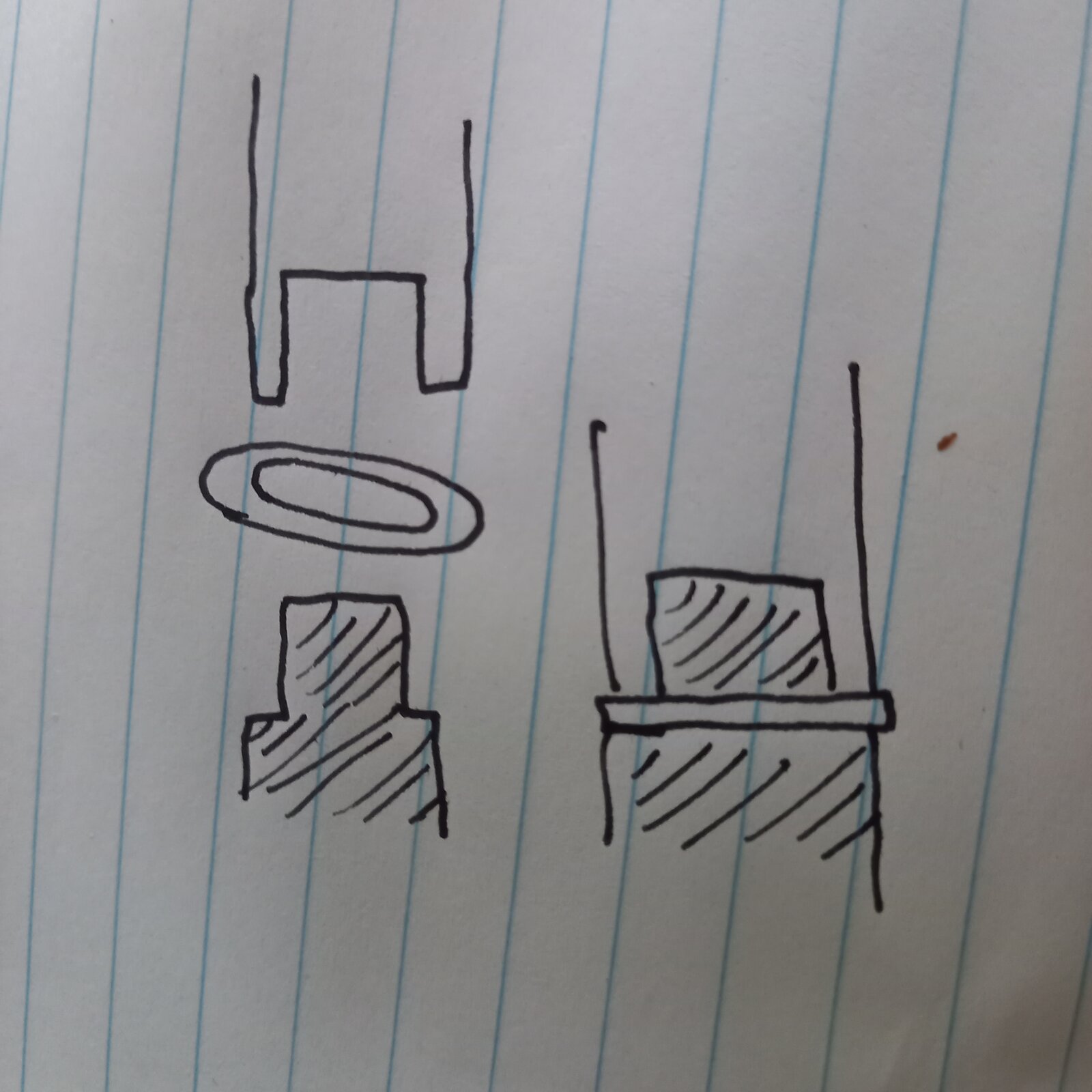

So if I glue two blanks together with a sheet of brass in between. Let's say 2 mm thick that is enough? Is that strong enough really? I was figuring you had to make at least a tube like this on the photo. Sorry for the rough sketch. I'm just having my morning coffee.

but then, I just realise, if you drill it. There hardly remains anything left of the tube I guess. That must be some strong glue.
Use epoxy. I spent several days making a segmented blank with a few woods and aluminum. CA glue does not hold and I have shattered fragments to prove it.
If you're making kitless/bespoke pens and want to use segmented blanks, I would strongly encourage you to sleeve the blanks to help improve the structural integrity.
