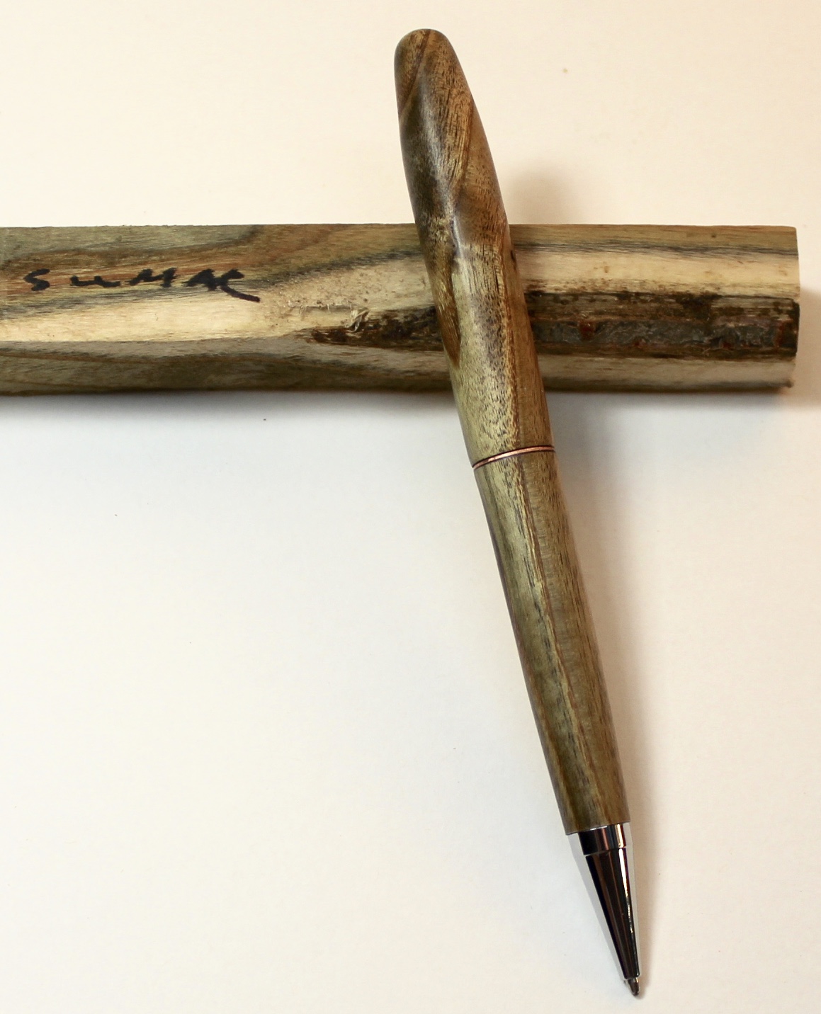

The picture is a simply modified slimline. About as simple as can be, but still attractive in my opinion.
