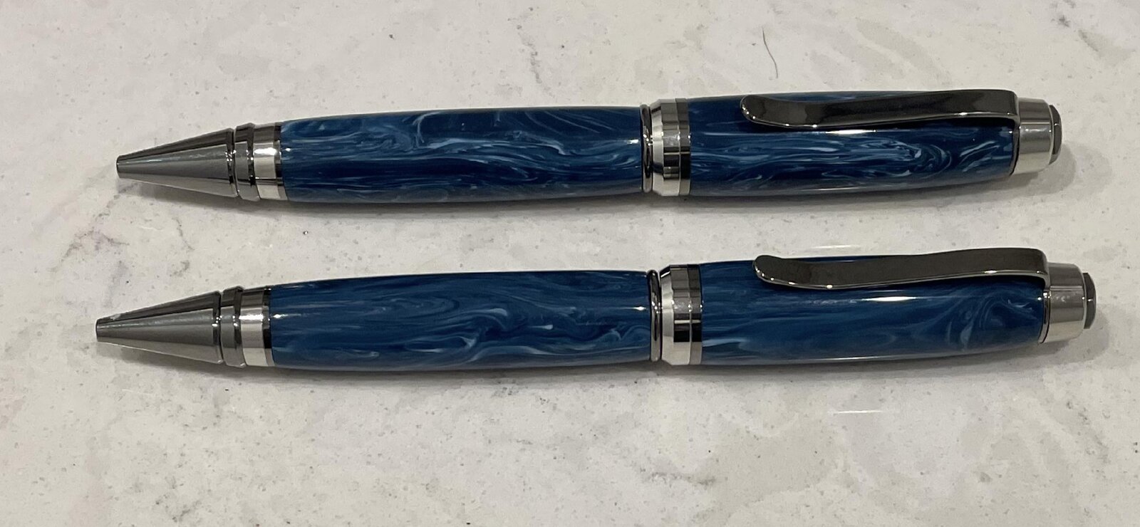

I've made several hundred "acrylic" pens with the following methodology:
1. Turn with round carbide insert
2. Wet sand with 220, 320, 400, 600, and 800 sand paper
3. Micro Mesh with all 9 pads
4. Polish with Novus 3-2-1, but I only use the Novus 3 Heavy Scratch and Novus 2 Fine Scratch (Amazon)
I've been very pleased with the results but I was wondering if I could streamline this a bit as it seems like the Novus does a really good job. I recently made 2 cigar pens (Berea Hybrid Black TG / Plat, available at EB) using the Amedeo Blue pen blank from EB (no longer available from them but try thegoldennib.com).
One pen is made using the above method, and another is made skipping all the MM, and going directly from 800 wet sanding to the Novus 3 & 2 polishing compounds. Can you tell which pen is which? Honestly, I cannot remember or tell which is which, so that's a good thing as I can eliminate the MM. I have also done this with other types of "acrylic" including the Rhino (polyester) and Acrylic Acetate with the same results.
Get rid of the sandpaper. I see no reason in the world where you need to start sanding with 220grit. use 400 or 600 and go to MM. Polish is just that polish . No way can we see what either pen looks like from a photo. You have it in your hands and can see detail better by certain light. This is my opinion.

Thanks for the feedback everyone, sorry the pic is not the best. The round carbide does leave tool marks so that is why I start with the 220. I also like how I can tweak the profile of the blank with the 220, something I'm not sure how well I can do with the carbide insert. I may see about the square insert so I can eliminate the courser sandpaper grits.
