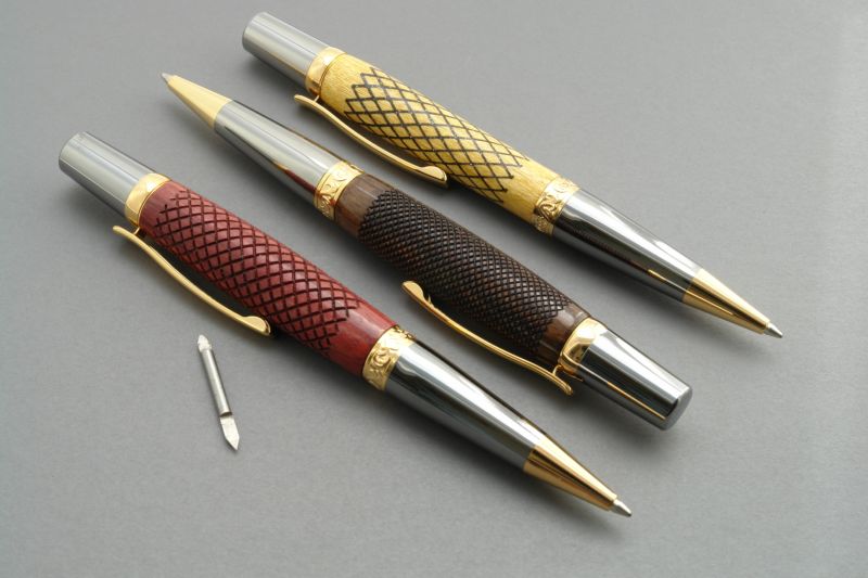

I just finished these three pens using the Pen Wizard. They were all done with the small engraving bit shown but any pointed bit will work. The darker, Macasar ebony used 24 passes, left and right. The other two used 12 passes left and right. They probably took about 15 min each. The gear box was set up for 12-60 and 22-50. The lemonwood pen is filled with epoxy and ebony dust with just a little silver glitter thrown in. They all have one coat of Danish oil and then buffed.

I really like the center pen.
JR, another great effort by the inventor/creator himself! Thanks for sharing these ideas with us.
Can you give us a chart showing which gears to change for these pens you've just completed?
