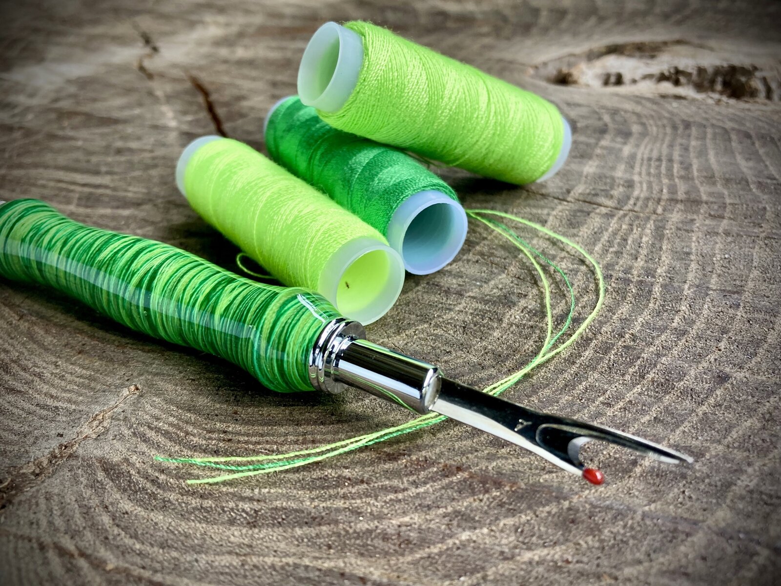

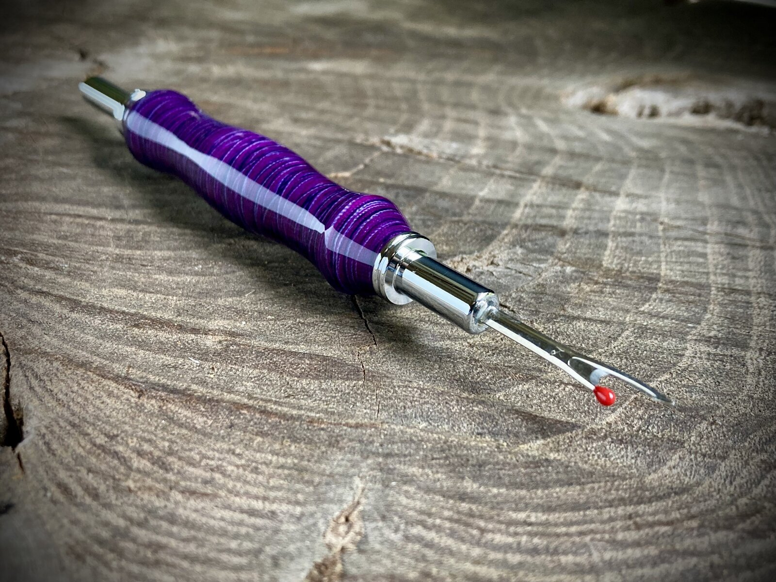

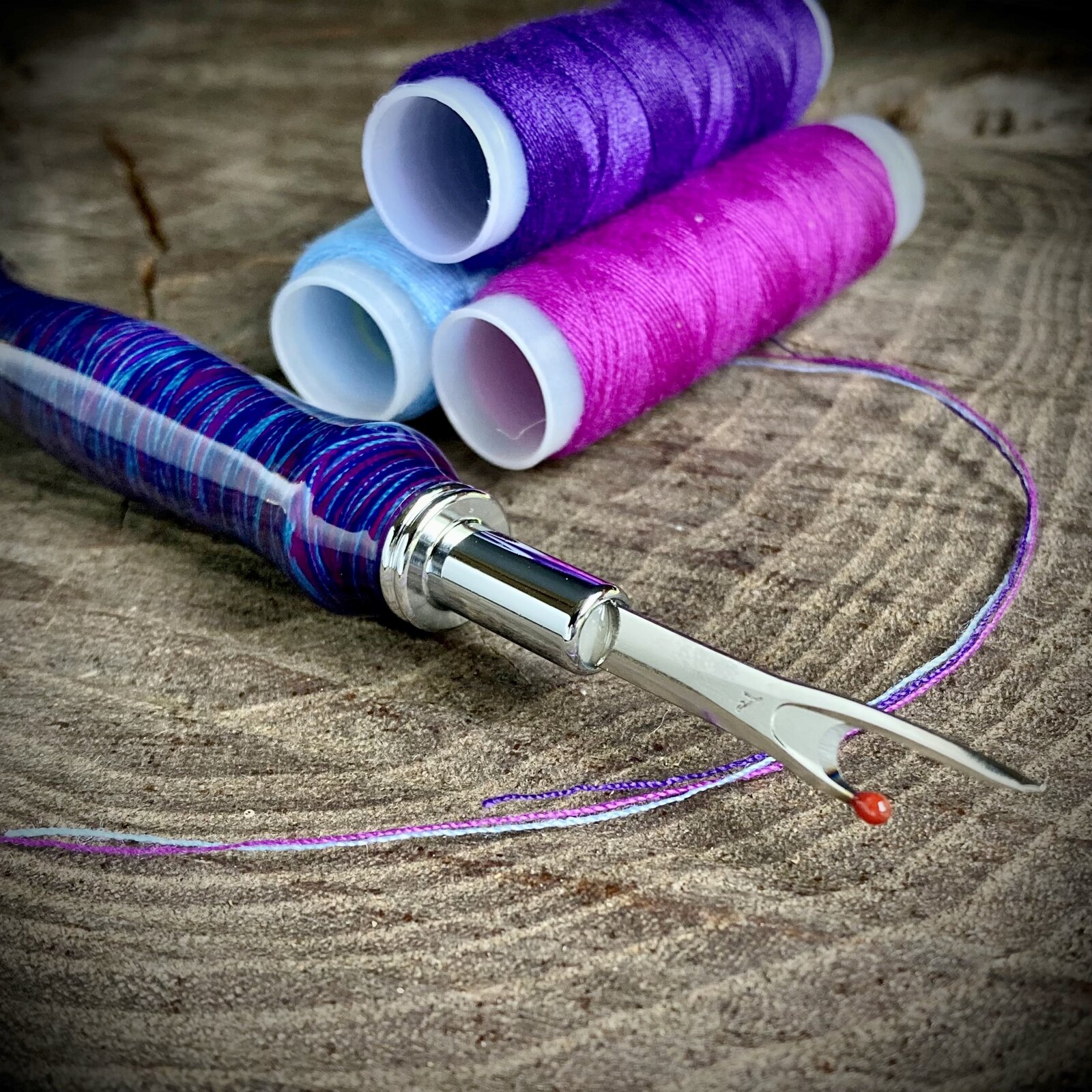

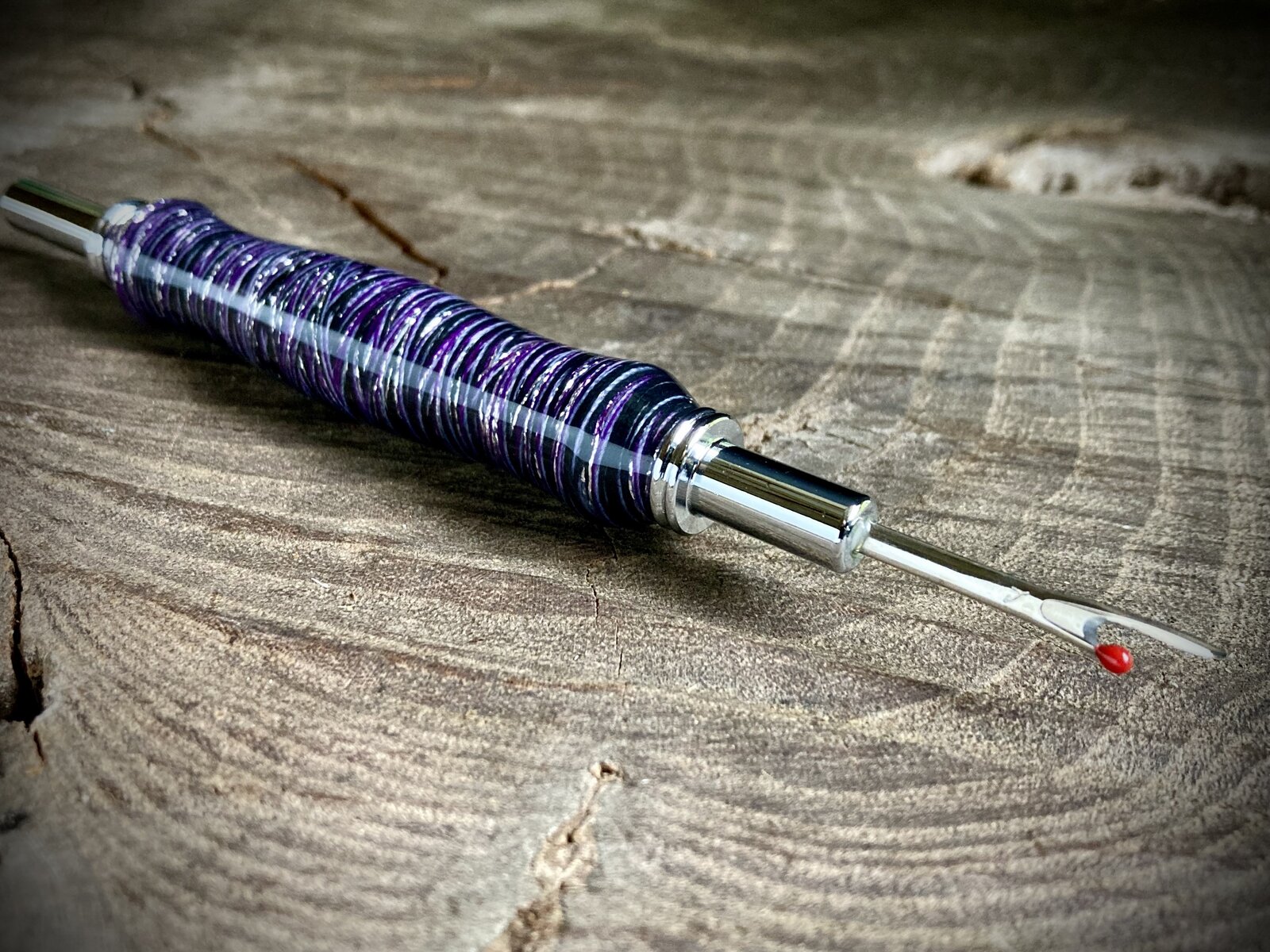

Thanks everyone for looking. 🙂
Yes, I wound the thread onto the brass tube using my lathe on 200. I tried to build up the thread to approximate the finished shape, and had the bushings in place to make sure I got the end dimension right. Then I cast the tubes in clear resin. I used McKenzie Thermoset Urethane. After shaping, I added ca to give me a harder surface.
