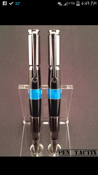

I think I responded to the wrong thread...I was saying that being a police officer myself, I have wanted to make these as well. I have not had much luck. I did, in fact, find a person on Facebook who perfected it. I will send you the photograph and if you have any questions, will give him your info so you can be in touch with him.
I am including the photo here. Not sure if the person who made them is a member or not. Hope I do not offend. However, he did post on Facebook so I am not sure if he would be offended. Here is the tribute pen he created....
I like those pens Michelle.. but I think I would like it if the blue was thinner.. Then it would be truly a thin blue line. But with you being an officer, you would know better than me, or most of us what would be the most meaningful
