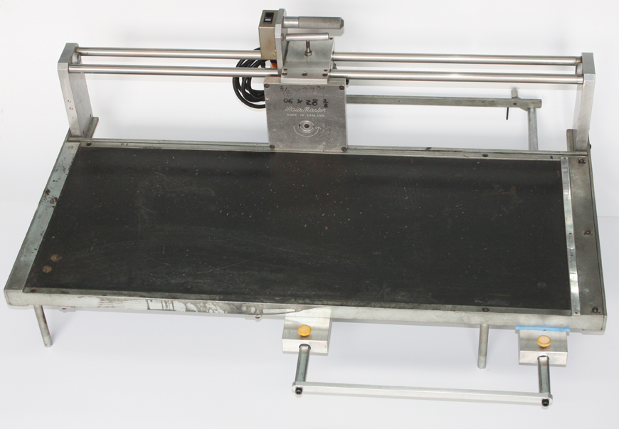

There is a saw put out for sign stuff. Will cut non-ferrous metals to 1/4". It ain't cheap( 1K+) but it works good. I believe engravograph has a version plus a few other engraving suppliers. Hard to find used
find used.
